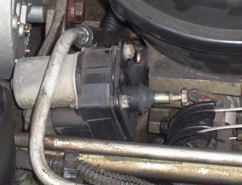

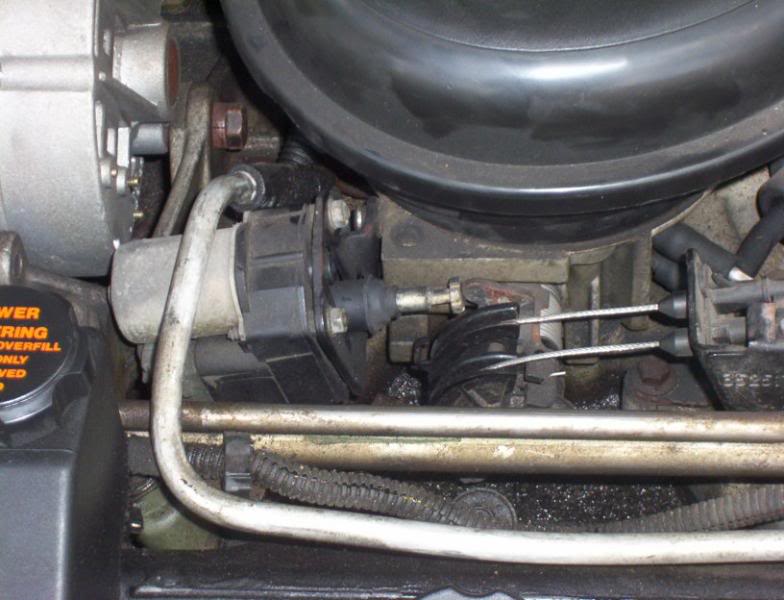

ok well i just tried driving it and now it starts up and everything, but when i put it in gear it stalls.
i took some photos of the piece that i think is the problem... someone tell me what it is and if its supposed to be doing what its doing in the video i made
http://s4.photobucket.com/albums/y12...=engine004.flv
go to that link to watch the video
is it supposed to be doing that? it doesnt seem like thats right, how it hesitates to rev and everything

The video is the idle air control, IAC .. it does that.
