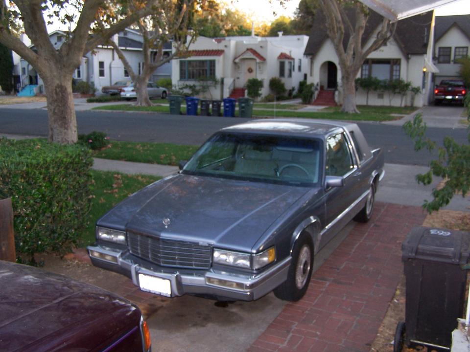

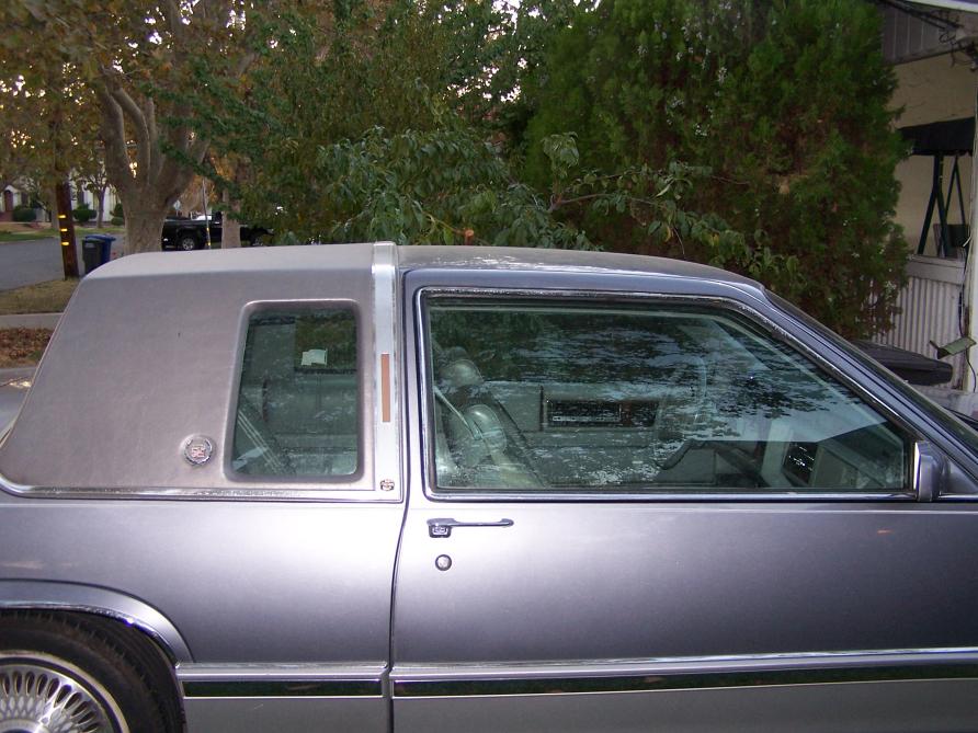

E&G designer series are "custom", often cabriolet tops, simulated convertible tops, grills, continental kits, sidemounts, etc. .. what was customized on your car? I see only two partial pictures and that tells me very little.
