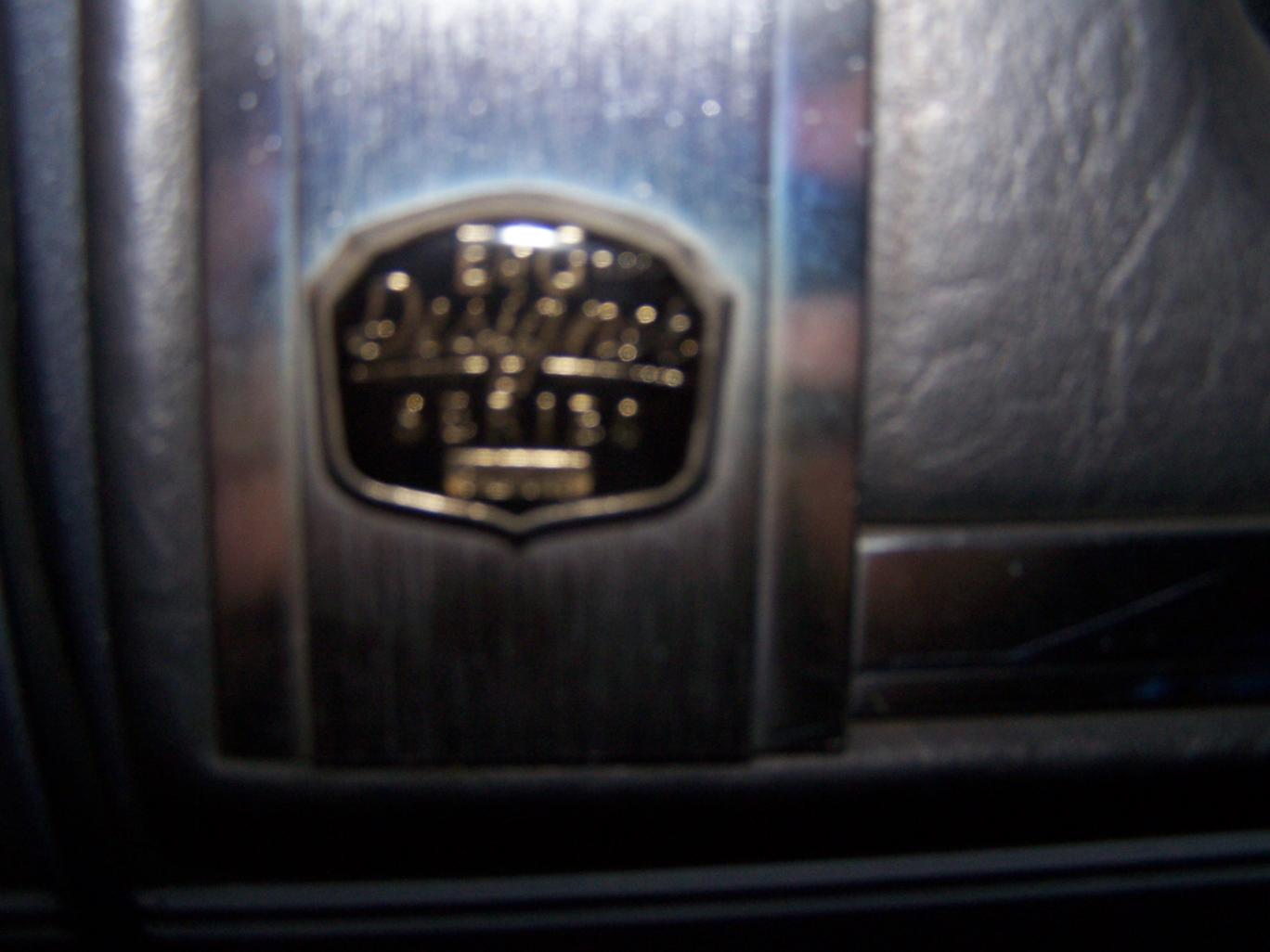

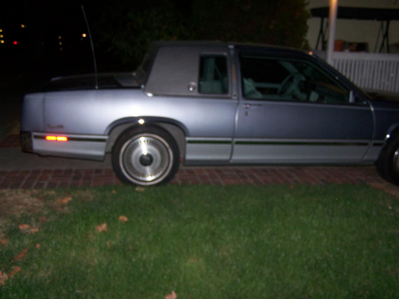

it will not start, I drove it home, it was running bad and next day it would not start test lights for fuel injectors did not light

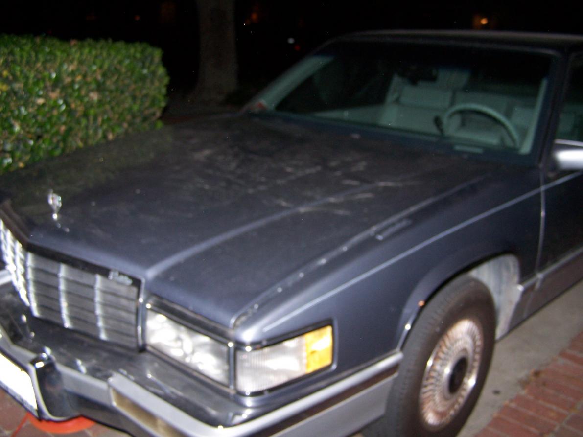

I got her to start, here is a pic of her. bad fuse two of them under the glove box, it still run ruff could just be a tune up is all it's needs
