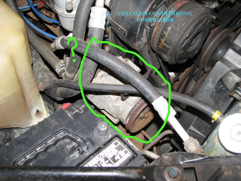

Can someone tell me what this is, even if it is the water pump. No belt on it, and doesn't look like one has been on it for awhile as the wheel is very rusted, and I cannot turn it by hand power. The part above it to the right in the picture is the Delco Air conditioning compressor, it says.
if it is the water pump, I'm amazed that after my 3 hour drive the car did not over heat, and my coolant sensor light did not come on... just remembered I switched sensors with my air sensor so maybe I have a bad sensor and no water pump idk. The coolant was low when I bought it a couple of weeks ago, I filled it up and it has not moved. If no water pump then no coolant used?

that is an emmision pump ......clean air type of thing

phew, glad it's not water pump. Thanks for info, and I'll prioritize it on my list.

if you are in a state that has emmision tests, you'll probobly need to get'r done. if not no biggy, unless your goin green......lol good luck

Emissions air pump ..It probably has hoses/lines that guide the air to either the exhaust manifolds and/or the catalytics.
What is the engine / car model we are looking at?

stealth, It's a 79 eldorado 350 5.7 gas, th325 and there are hoses, like mad, running to and from it.
As far as a detriment to the pollution of air goes I think the rusted-out hole, midway down the car, in the exhaust gets first bid for fundage.
Then next on the safety/frozen things list is the bum drivers side front caliper. I've got my hands full with this car, and loving it btw.
