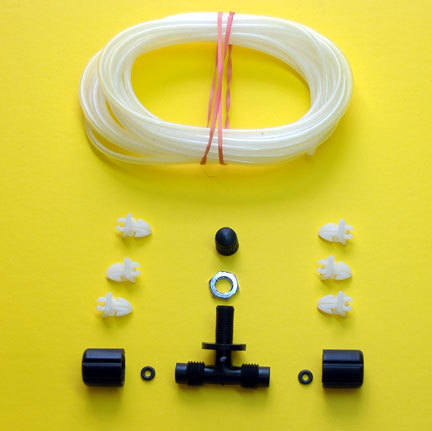

Ok for many of us here we own cadys with Air ride. some of us have spent money replacing struts and later find out are car still is riding low and having ride being very floaty or bouncy than normal. Well i am going to work on fixing this problem. Im going to eliminate the use of the compressor by using 2 air supension kits which i will spend roughly $30 on at my local auto parts supplier. Each kit will adjust one pair of struts.
I saw the kit used on my brothers 89 Brougham which only used one kit for the front shocks.Its adjustable and easy to access. Each kit comes with 20ft of airline and what you see in the pic.

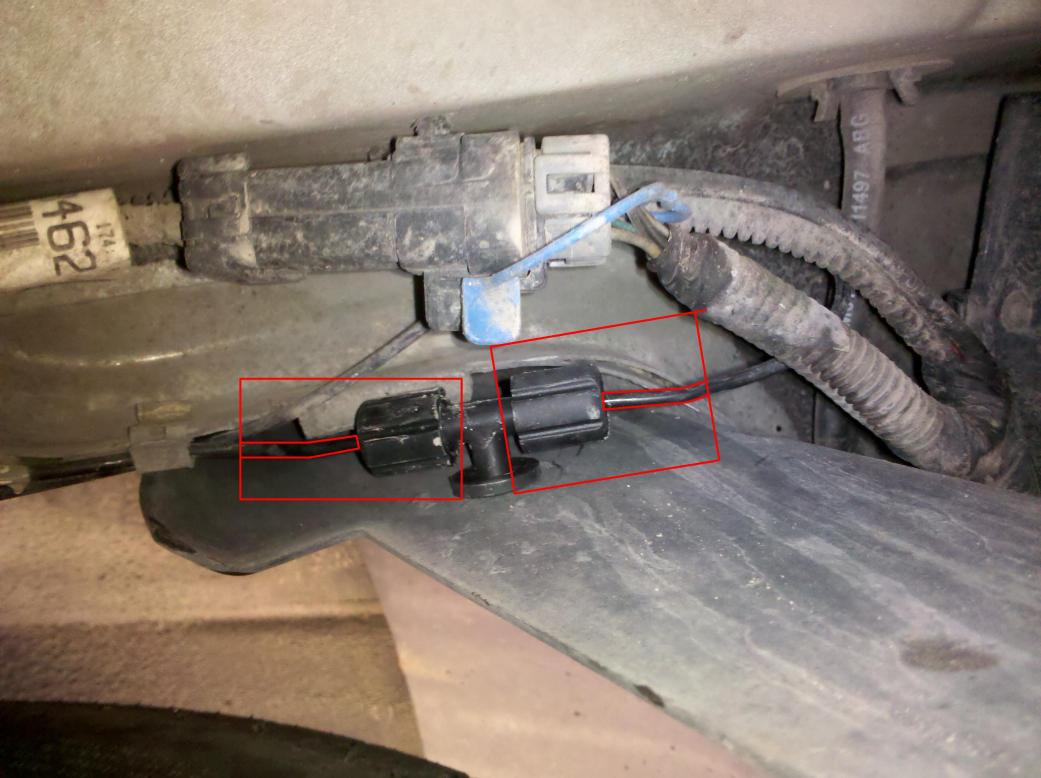

what i did was cut the 2 air lines that ran into the compressor. The compressor is on the passenger side rear. Right behind the rear wheel. you need to remove the plastic shroud by removing the 2 screws and 3 plastic retainers. Once removed you can see the one line that runs from the right rear strut to the compressor location both the rear lines are side by side at the compressor. So what i did was cut that as close to the compressor as i could.
Once that was done i took the two black caps and slid them onto each line followed by the small rubber O-Ring. (Seen in the previous post)
Then one line at a time i screwed the caps onto the T splitter only about 2 turns just to get them started. Then i pushed the line as far into the splitter and finished screwing the caps on till they were as tight as i could get them with my fingers. When done it should look something like the first pic below.

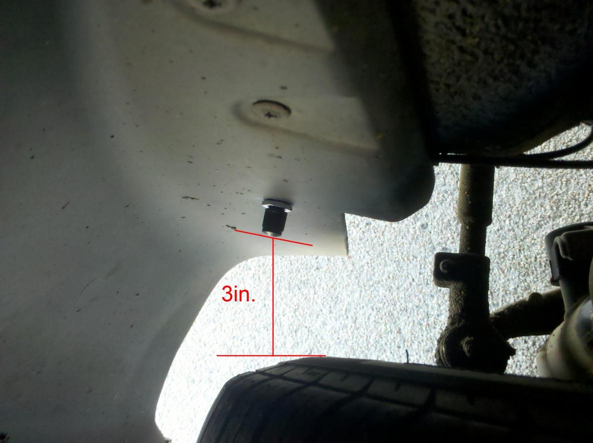

Next i drilled a hole in the plastic shroud to fit the valve stem. the reason i chose this location was because it was easy to access and i didnt have to extend the air lines. There is enough clearance that nothing will hit it.

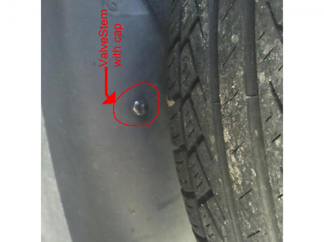

Once you have the hole drilled to fit the valve stem insert the valve stem and screw on the small chrome nut. Only tighten using your fingers cuz the threads are plastic and will strip easily.
Once this is done it should look like this. You are all done for now and just need to add air into the system. Have with you a TPS gauge and add no more than 70psi but have at least 25psi. As you add air you will see the car rise which is good. Just make sure to check for leaks, by using a spray bottle with soapy water. If no leaks are found you good to go and fixed your problem for under 20 bucks.
