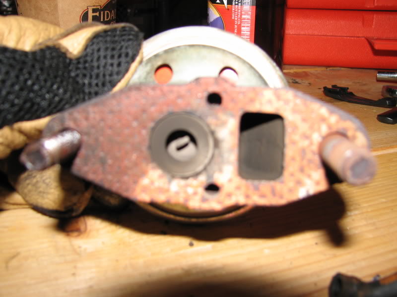

Pulled the EGR valve off, one bolt almost broke on me so I tried some wd40 and tightened it then loosened it, and that still didn't work so PBR'd it and it came smooth. This is what it looks like, and I pushed the spring loaded valve and it still moves so I'm assuming it is ok. I would shoot some brake cleaner or carb cleaner in it if I get the forum ok, I will not shoot it in the hole just on the spring-hole, but there is some kind of hard plastic ring, in the spring hole, i don't want to effect:

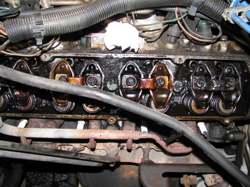

here is the valve cover and pieces of gasket, the far left lower bolt was very loose on removal:

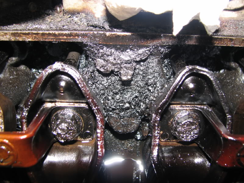

and here is the gunk:
can I just start blasting this with brake cleaner? CRC Brake Parts Cleaner. And slowroll I know you said spray brake cleaner down the push rods, but I didn't imagine that I would run into this much sludge. I want to just blast it all.

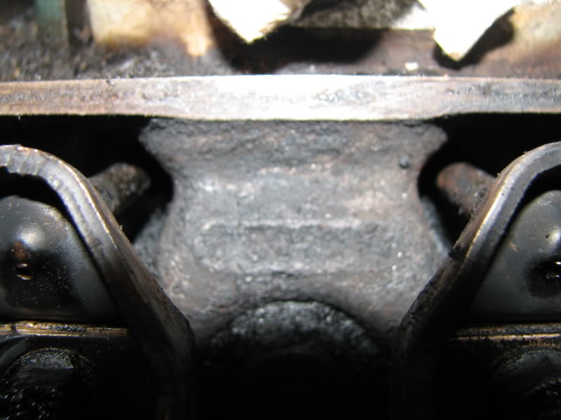

ok well cleaned up around the push rods and blasted brake cleaner down the rods. They were sick with sludge and I ended up using a thin knife to get around the rods to break up the gunk, then blasted and repeated a dozen times. I filled a towel with a lot of sludge as I had placed an old towel under the cover area, over the spark plugs and shoveled junk.
Here's the after:
not crystal but way better. I can tell the brake cleaner doesn't have the breaking power carb cleaner does, but sacrifice for less residue (if I'm learning anything).

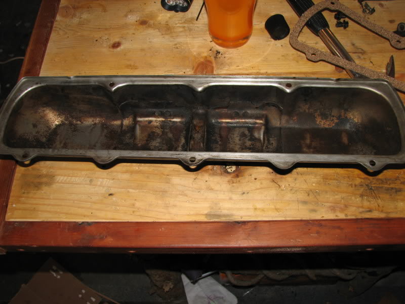

Here's the cover:
now for the gasket and then I will assemble then do the other side.

Carbon build up was not abnormal since it centered near EGR. It may have been a little long between oil changes at one time or another. The cleaner was to spray thru the the push rods, to be sure rocker arms got oil. I am not into engine flushing other than dealing with water/oil mix it can cause problems on older or high mileage engines. If your are going to replace oil pan gasket running motorflush just prior to removing oil pan should be ok
