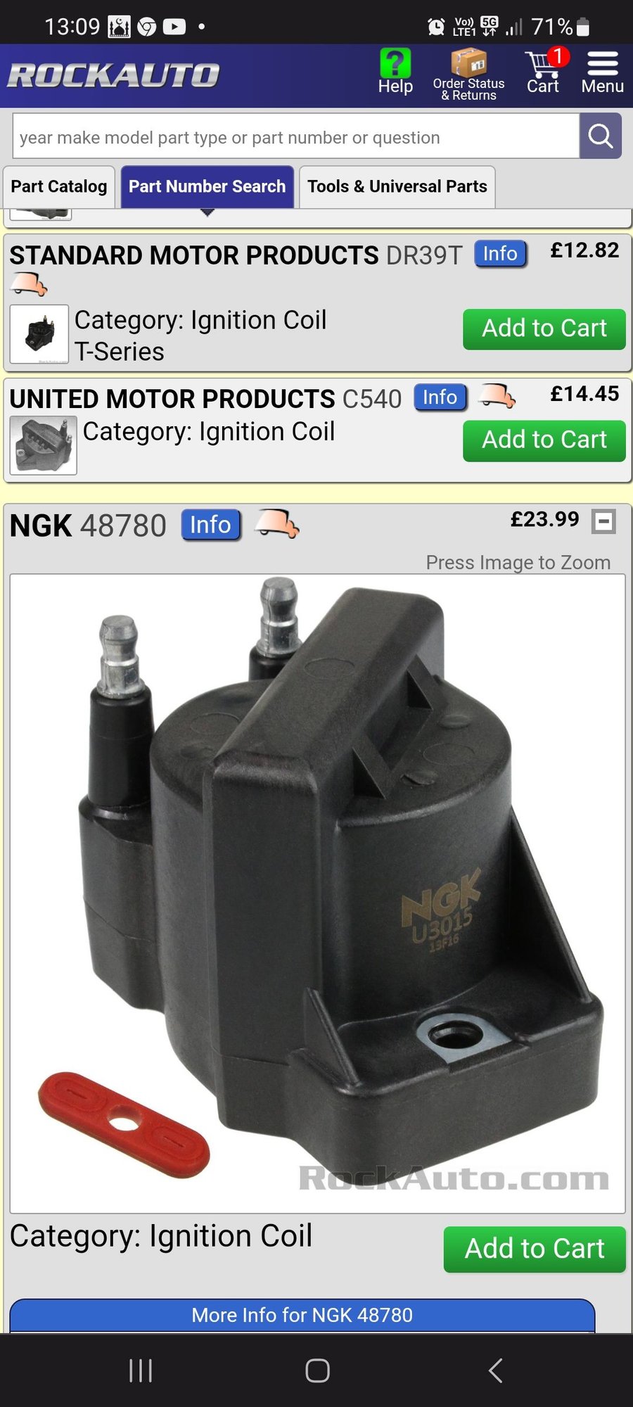

Default Rough idle cadillac seville sts 4.6 v8 2001
Originally Posted by deadgirl
did you ever figure out what was going on with your caddy? my baby is spending the night at the mechanic's for a very similar problem.
mine was a continuous shaking and was not very noticable. i am predicting a simple plug needs to be replaced.
some advice would be helpful just incase the mechanic tries to pull the wool over my eyes.
I had the same issue with car vibrating a lot and while stopped at the lights while in gear engine would just cut off. I replaced my idle sensor and an ignition coil car runs smooth as when bought... you can't even tell the engine's running.... engine ticking as should.
