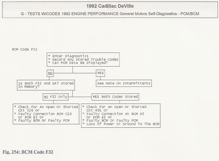

Here is some info on these two codes. Looks like a connector, or wiring issue that is causing both codes to set together.
Attached Thumbnails 1992 DeVille Intermittent Service Engine/Service Vehicle Check Engine Light-f32pg2.jpg   1992 DeVille Intermittent Service Engine/Service Vehicle Check Engine Light-f32pg4.jpg

Update 19 April 2010 - checked all of the connections between BCM and ECM and found no problems; eventually resolved the issue by replacing both the BCM and the ECM - Auto Zone had the parts for about $100 each; replaced the BCM first and that resolved one of the codes but not the other, so replaced the ECM as well and that resolved both codes. Car is running fine now with no service engine or service vehicle lights or recording any codes.
