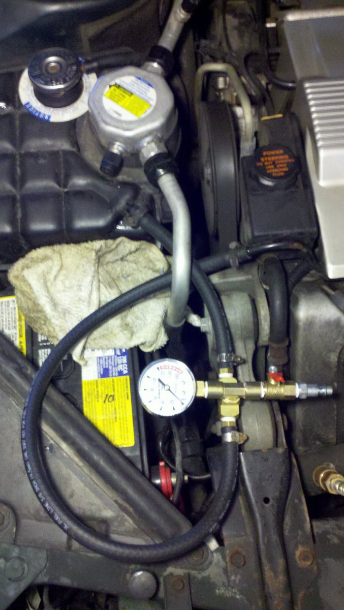

Being far too cheap for a fancy Coolant pressure test kit, I built my own. I'd like to see if anyone can tell me if there is any reason my fabrication will not work.
I pressurized the overflow hose into the reservoir. I hooked a gauge up to it, and pressurized it using 30PSI inlet pressure until i reached 15PSI. I see no reason it should not hold pressure, nor be a reasonable place from which to pressurize the system. I first want to make sure my method is sound (see pics below) because...
It doesn't hold pressure at all. I have no leaks in my apparatus, having tested to 40PSI with the hoses capped.
Are there any other reasons that my cooling system will not keep pressure, or is this a pretty clear indicator of a problem? I imagine the latter, and am sad at the thought.
Here is a pic of my pressure tester installed, non-pressurized. I built it using two pneumatic Tee-pieces joined together with good amounts of thread tape. A simple air pressure gauge on one end of the top Tee, and a air compressor valve on the other end. Then you just hook this Tee up to another Tee made for the through hose, and voila! easy peezie.
