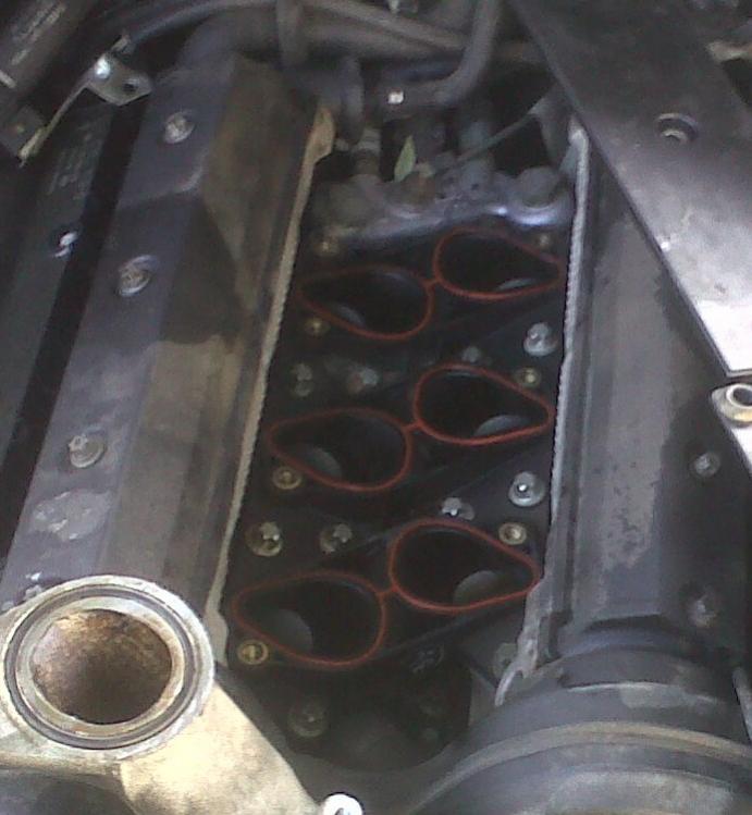

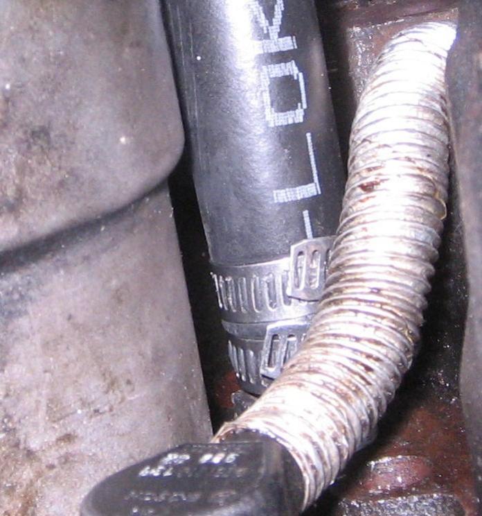

I removed the oil cooler that goes under the intake manifold, since the cost of that thing is too expensive, I sawed off the oil lines and bypass
it at the oil filter area where they originate I figure the oil is already pretty
hot so a few more degrees won't harm but I am no expert in fact my brother says I am an idiot, what you think?, I was thinking why cadillac put the oil cooler inside the engine in a compartment full of water that gets as hot as 220 degrees?
Attached Thumbnails 2000 catera with a V6 - Oil cooler removed,bypassed lines, give me a comment-cad23.jpg   2000 catera with a V6 - Oil cooler removed,bypassed lines, give me a comment-cad24.jpg   2000 catera with a V6 - Oil cooler removed,bypassed lines, give me a comment-cad25.jpg   2000 catera with a V6 - Oil cooler removed,bypassed lines, give me a comment-cad26.jpg   2000 catera with a V6 - Oil cooler removed,bypassed lines, give me a comment-cad29.jpg

the last picture shows the bypass a high temp special hose, 1 foot long that curves to the other side of the filter and is tightened the same way,
the car is a 2000 catera with a V6 3.0 150K miles.
