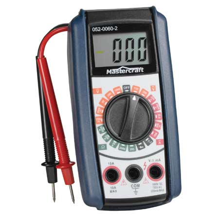

I got this one for $9.99 on sale, a must have for any backyard mechanic.
perfect !
