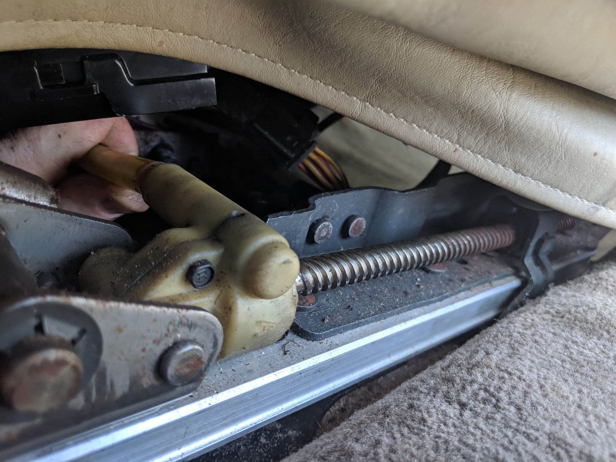

Hello all,
Got my Fleetwood today!!!! Love it!!!! Here is my first question;
1. When I try to put the driver seat back, it is pretty close to the wheel, only one side is going back, like the seat is twisting - the side nearest the passenger sie goes back, but the side of the seat near the driver's door is just stuck. What can I do? Is this a common problem - so my forward and reverse on the seat is paralyzed on the driver (left side of the driver's seat) So it seems the seat has seemed to have had stroke.
Thanks!

I went out and adjusted the seat to the highest position possible and started messing with the cable to the driver side. It looks slightly pulled out from the plastic piece on the track that connects on the seat track with the worm gear. I was able to get the seat to move forward LOL, but now it won't go back no matter how I twist. I created a video and here are some pictures. Any ideas folks? I have not messed with power seats that much.
Thanks!
Video here - please excuse me a bit - my mom passed not too long ago and I am still scattered:
Pictures here:
Old Sep 4, 2019 | 01:44 PM
tinkerdrawer's Avatar
Joined: Aug 2019
Do I need something like this? https://gbodyparts.com/power-seat-co...175-p-546.html
Not sure how to unhook a motor - all advice welcomed
