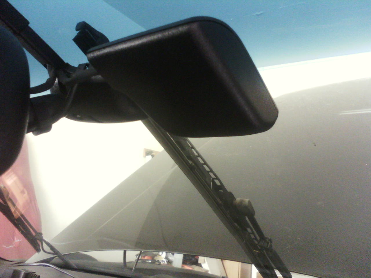

Just tried unpluging and pluging connectors and no go. I do not have a manual as of yet. One more question I have is that I think the ETC had the "rain sensing" wipers? Does that have anything to look into? I also attached a pic of a black box that hangs next to the rear view mirror...what is that? Thanks

Anyone??? What is that thing?
Old Sep 8, 2016 | 06:14 PM
That would be rain sense sensor. You will need FSM or Alldata to solve it.
