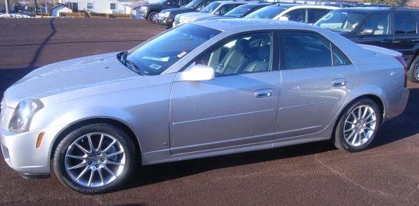

Follow up:
It was the leaky pinion seals in the differential that were not repaired correctly the first time. All good now.
Underdog, I have included a pic-Thanks for all your help everyone!
Attached Thumbnails Minor Leak/White Smoke/Hesitation-capture1.jpg
Old Apr 30, 2010 | 05:04 PM
Underdog's Avatar
Joined: Dec 2007
Posts: 166
From: Middleburg Fla.
Sweet! I notice you have the rear deck spoiler. Does it also have the wire mesh grille similar to the "V"?
