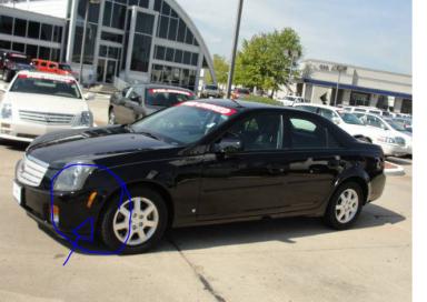

Some idiot in the Wal-Mart parking lot left his/her cart out, and it was a windy day. It mosied on down and hit my CTS on the drivers side signal light, and scraped some blue paint on the car. The blue came off, but the signal light looked like someone put a Bi-Bi Gun to it. To replace it, would the whole fender have to come off? Also where could I find one of them. I've checked E-Bay/Kijiji etc.

Actually, the method of gaining access to the sidemarker light is by removing the front facia, including the grille and front bumper cover. Prepare for that if you ever need to work on the headlights, too. Before you pull all that stuff off, I would remove the plastic "air deflector" from underneath the front of the car. You have to do this anyway to remove the facia. See if you can reach up to the side marker from there. The light assembly is only held in with a clip, press the tab and push the top of the cornering lamp outward. Lift up on the cornering lamp in order to remove it from the facia. This info came from my 05 CTS service manual. I think it should be pretty much the same for an 04. Good luck and let us know how it works out.

I have not tried it yet myself, but it's only a matter of time until some light or other burns out. It just seems like alot of work to change a bulb or lens. Now that I look at the directions a little more closely, (and the accompanying drawings which suck) it says to remove the "front fascia extension", not the whole front fascia. And if I'm looking at this correctly, the "extensions" are the plastic pieces inside the wheel well towards the front of the car. They appear to be held in with plastic push pins which you just pull the center out to release them. THAT makes a whole lot more sense. It looks like a splash shield, behind the headlight assembly and in front of the tire. If you take that one piece out you should be able to get to the side marker light.
