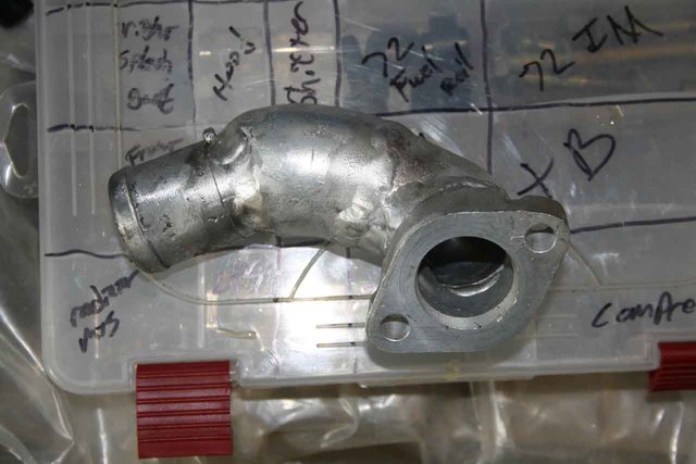

Old 09-26-2009, 06:15 PM
Join Date: Jun 2007
if you remove the existing sensor, the car will not run properly. dont do it.
the problem with all the solutions for added gauges that come to mind is one compromises the coolant system and we dont want to do that.
in the old school days, there was a aftermarket gauge where the sensor for the gauge was strapped to the radiator hose .. not exactly accurate, but it did read the temp of the coolant flowing in the hose close enough.
i be concerned about pulling a freeze plug for this matter. these engines do drive with considerable vapor pressure and can easily blow the make shift seals.
if you really really must do this, get a 4" long SS or copper pipe of the same size as the radiator's and cut the upper rad hose at a good place,install the sensor in that pipe, clam the hose. carry a new hose just in case the installation fails 100 miles from no-where.
better yet, weld/solder an extension to the flange .. see pic. then drill and tap for the sensor.
