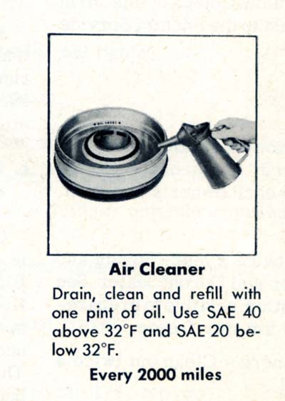

Its time to clean the air filter on the 56 (Caddy). Its got one of those oil bath air filters. Can anyone steer me to a how-to post or some instructions.
Hi DaveK
from the 54/55 cadillac shop manual

I was thinking K&N filters and the K&N recharge kits, until I saw that.
thanks

Hey Guys:
It doesn't get any better than this. Thanks very much for the help. I'm headed to the garage to get dirty. Thanks, again!
