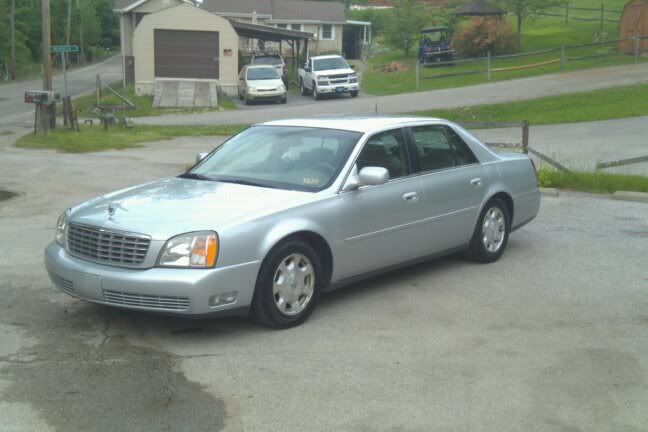

My 02 Deville Is Dead
1-Turn key to start and...nothing. This happened once before and I pulled codes and among them got: NO DATA PCM and NO DATA VCM
I cleared them, tried again and the car started and has ran the few times its been started since. I took it to a shop to have a brake line repaired and to my dismay, its still there because I cannot get it to start this time. Once again it says: NO DATA PCM and NO DATA VCM.
I can't give you the other codes right now (I doubt they're of any importance at this juncture given the big two I've listed) because I pulled the PCM and brought home with me to inspect. No nasty smell or visible failure. Please, try to point me in the right direction. Where is the VTD module?
Car is 2002 Deville base model.
