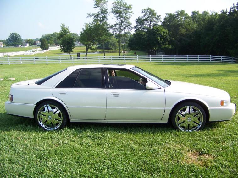

Unhappy help me please
guys im new to here im having the worst time i just bought a beautiful cadillac 1994 seville sts and it is messing up on me two days into owning it ok here is the thing it acts like it has a real bad miss when you take off its allmost like the motor shuts off and comes back on it will do it for a sec then go away untill you hit a few miles per hour faster and you can feel the miss at 50 or 60 the only code its throwing is p095 engine stall detected i replaced the fuel filter plugs wires and bought two coil packs today to go through the groupe now when i hit the gas it misses at a idle and sticks at higher rpms i can hear a backfire in exhaust please help me people i just spent every penny i had and i am stuck i am more then open to any ideas
