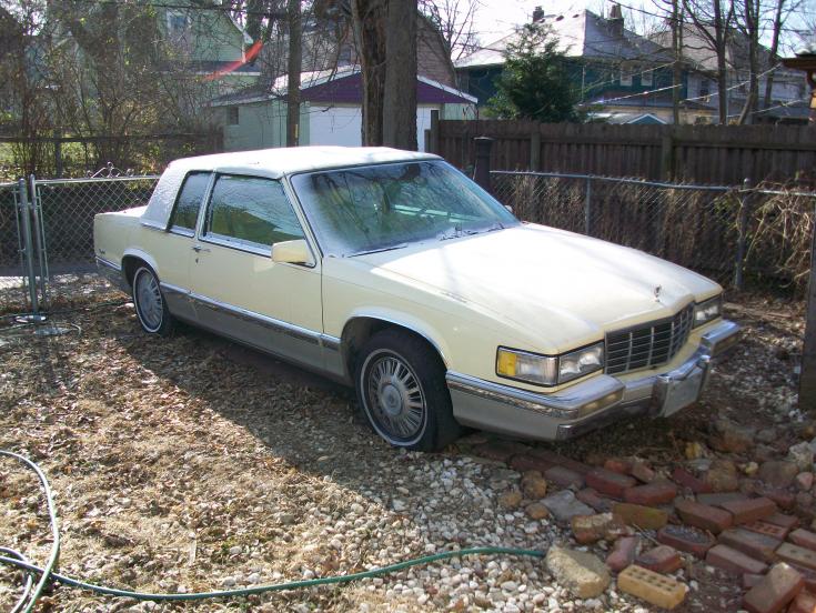

my Coupe('91) revs fine in neutral and park, but when the throttle is about 2/3 or more open in gear(most noticeable in the top of 3rd, around 40 mph) it surges. Also, when i STAND on the throttle and it kicks down, nothing. No power, you can just hear the engine stutter. Normal acceleration is fine, except the aforementioned surging near the top of the gears Is this a fuel delivery problem(maybe sending unit, TB, injectors) or transmission problem?
