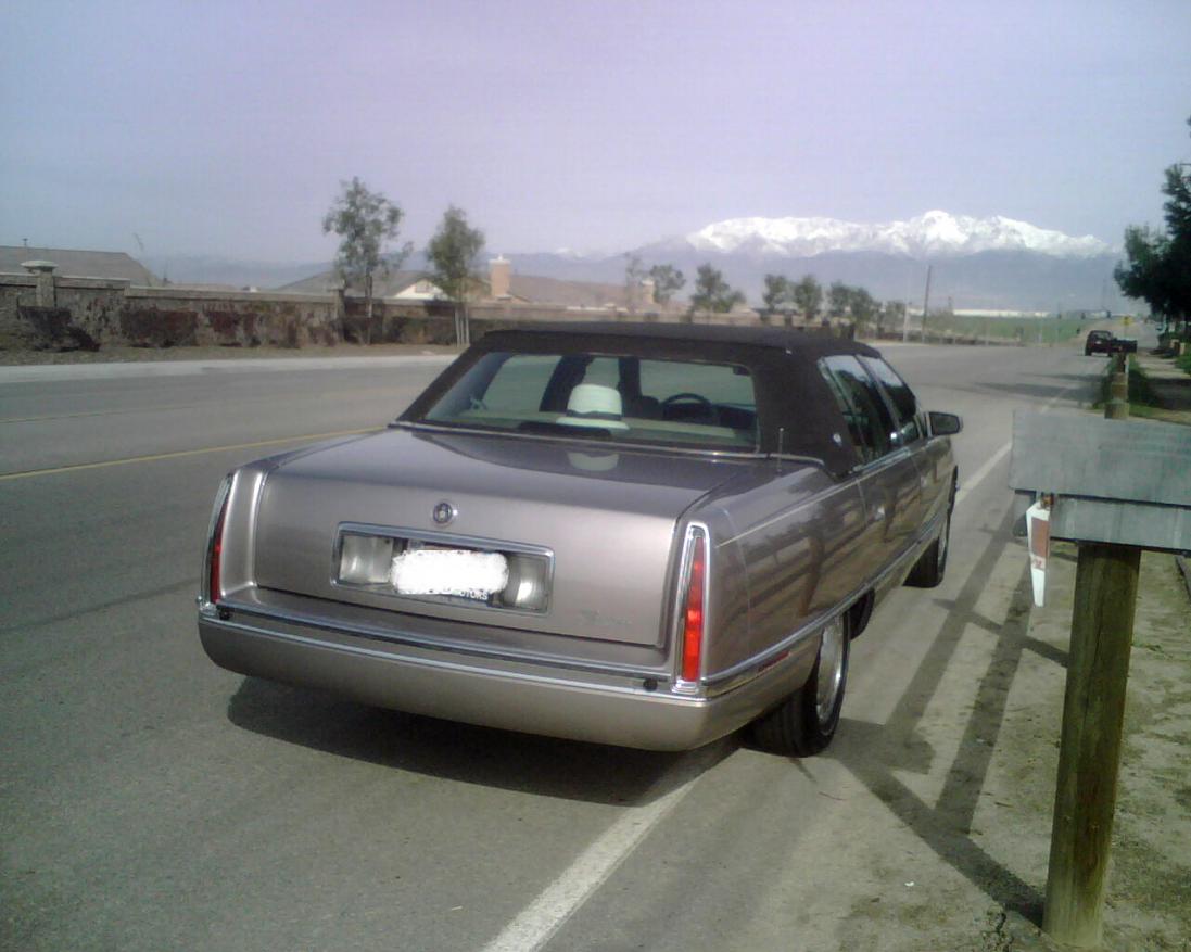

Was driving this morning on the freeway headed to work when all of a sudden i hear a somewhat for a tear, or a burst, a hot fluid started coming down from the bottom, inside my car (by the pedals and below the glove compartment) Mats got all messed up but that's the least of my worries.
The "Coolant Fluid Hot" and "Engine Idle" signs came on, and smoke started coming out of the AC vents.... a little bit at first.. but then it came out strong forcing me to pull down all my windows.
It started a mild but firm rattling noise and so i just turned back and went home
Any suggestions? Comments? Questions? Anything would be helpful. Thank You.
1995 Cadillac Deville
136k miles
V8 4.9
