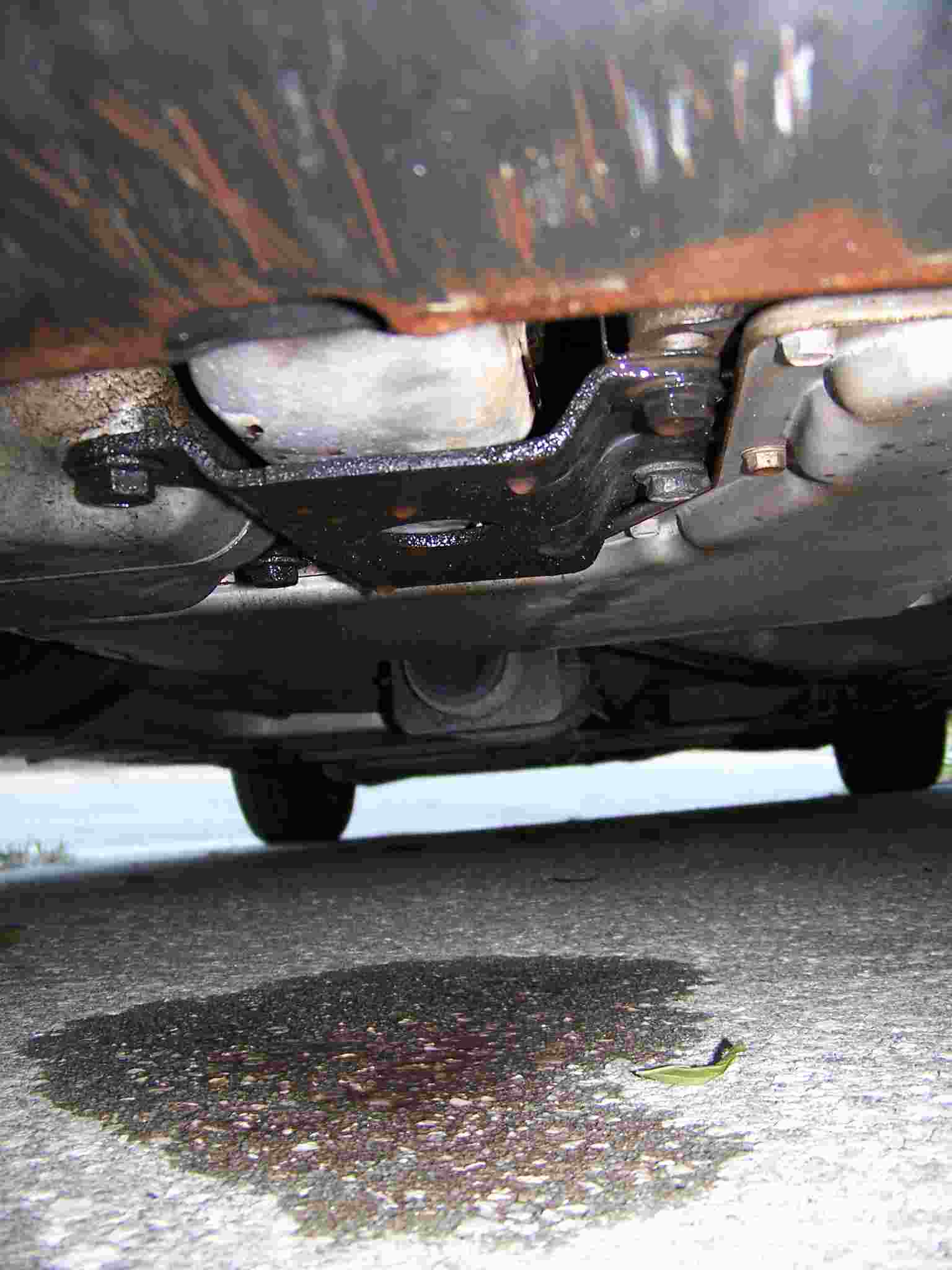

I haven't smelled inside of it to see if I smell fuel but noticed dripping from under the car. It looks like part that is wet is just wet because it's underneath wherever the problem is occuring. I took a few pictures of the drip as well as the engine to show what kind it is.
If anyone can take a look and see if they have any ideas it would be much appreciated.
The pic from under the car shows a leak from the water pump area. Not an uncommon problem. The water pump is on the driver side front of the engine, and it runs off of a belt from the camshaft. Replacing the water pump requires a special tool to get it off. With the tool, it's a 20-30 minute job...without the tool, it's a major pita. First check to see if it is just a hose leaking at the pump, or the pump itself. My guess is it will be the water pump, but you might get lucky.
I would first verify the source of the leak. While the pic shows leakage in the general area of the water pump, it could be something else leaking, such as a hose, or even a head gasket(rare, but possible).
The pump tool is two pieces, and as far as I know, it is simply a water pump removal/install tool. The Northstar engine water pump does not bolt on, as a "normal" water pump. It basically screws, or "twists" onto the housing. The tool grabs onto the lugs of the pump, and allows you to turn/twist it off/on.
The water pump should come with new o-ring/gasket, so all you would need is coolant, a little time, and a lot of patience.
