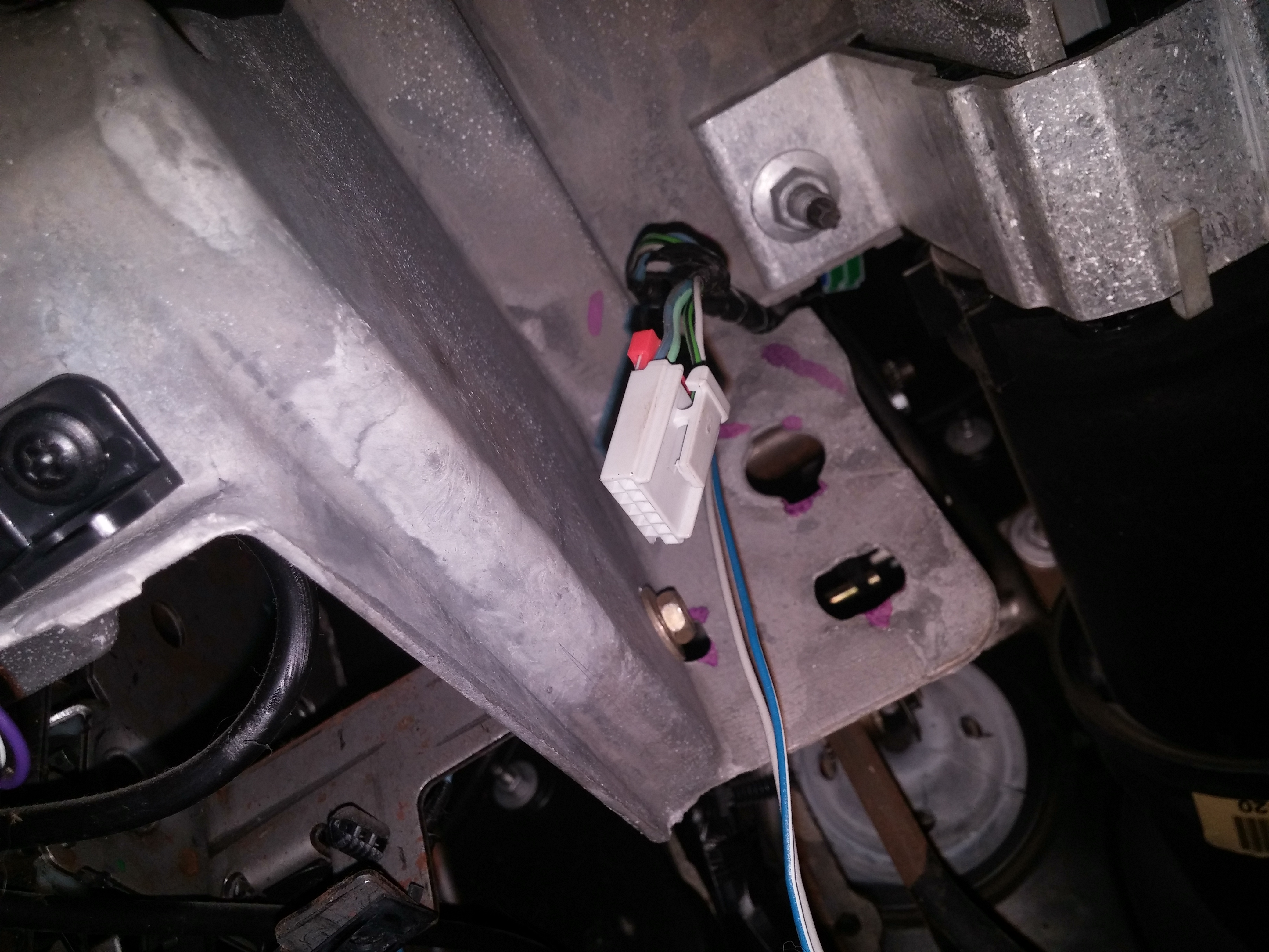

I also forgot to mention that under the pedal area it looks like something is missing (like a brake switch or brake sensor for the cruise control). Can you tell me more please?

Picture does look brake switch is missing. Do you have the trouble trees to follow. I would follow U1301 breaks in serial data can cause all sorts of trouble. If PCM has been "Tuned" to bypass function I'm not sure how to diagnose thru that. If you know someone who does "tuning or data logging" they maybe able to see changes to PCM. Your other choice is trying to find a used PCM to substitute or reflash with correct programming. I wouldn't want to reflash one in car since it will run with it, after reflash it might not.
