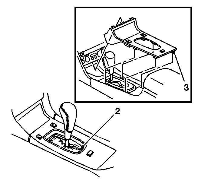

From FSM:
Do***ent ID# 556170
2001 Cadillac Seville
Trim Plate Replacement - Console
Removal Procedure
1. Block the vehicle wheels.
2. Put the shift lever into neutral (N).
Important
Do not use the convenience door opening as a leverage point.
Notice
To prevent component damage, DO NOT use metal tools to remove the trim.
3. Remove the console trim plate.
A. Insert your fingers (if necessary, use a flat plastic tool) between the trim plate and the PRNDL at the RH rear corner of the chrome trim (2).
B. Gently lift up the trim plate in order to disengage the RH rear corner retainer (3).
C. Use the same method at the LH rear corner and the two front corners of the chrome trim in order to disengage the remaining retainers.
4. Lift the console trim plate assembly upwards from the rear edge and pull the assembly rearward.
5. Disconnect the electrical connectors as necessary.
Installation Procedure
1. Connect the electrical connectors.
2. Guide the forward edge of the trim panel (1) into the lower instrument panel (IP) opening.
Important
Make sure the retainers are aligned properly before attempting to engage the trim plate.
3. Align the trim panel retainers with the top of the console, and press down firmly in order to engage the console trim panel.
4. Shift the vehicle into park (P).
5. Remove the blocks from the wheels.
