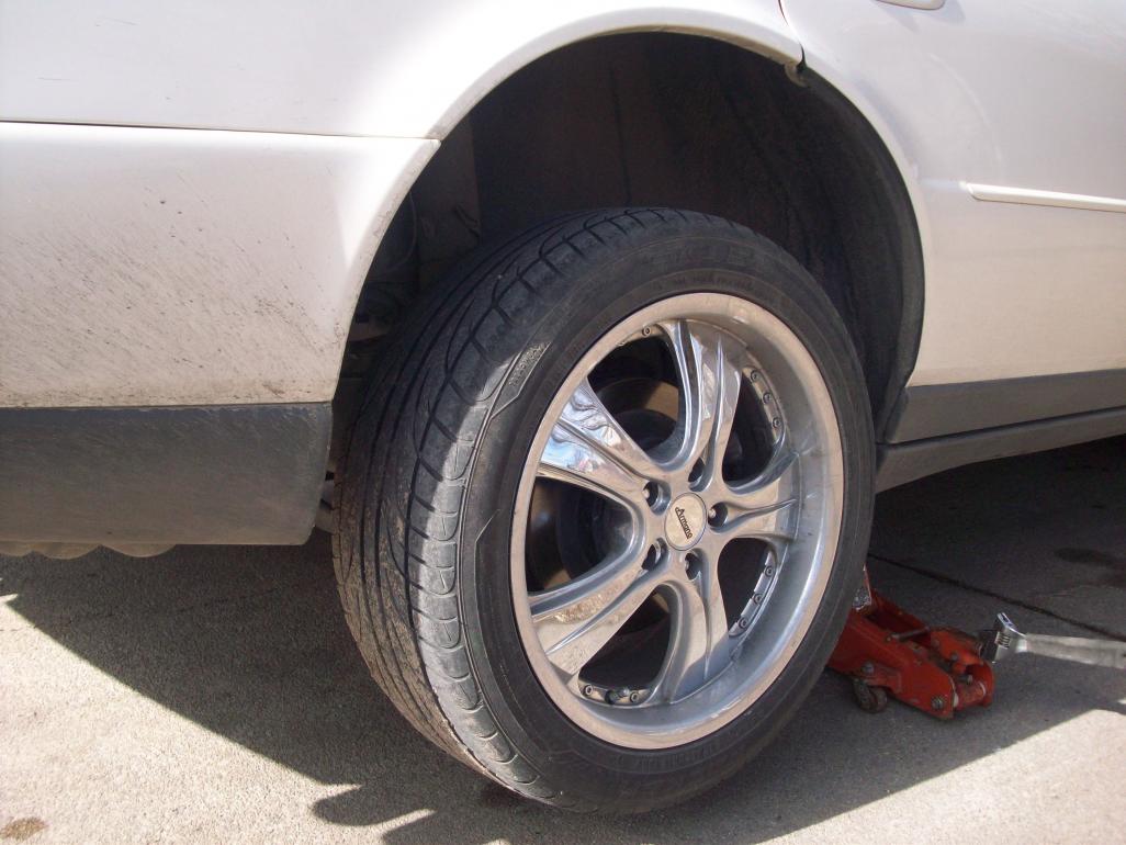

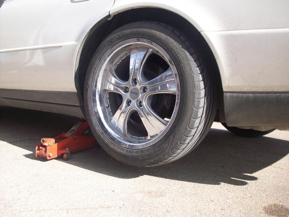

Today was nice enough i went and jacked up the back end of my seville. This is what i noticed first while i was jacking up the car, about 4 pumps of the jack i noticed the drivers side rear wheel wont extend all the way down and was already off the ground, and the passenger side was still touching. so i think that the rear strut is stuck and not allowing the strut to extend. the passenger side strut has huge wholes in the air bags of the strut so im going to be replacing both struts. but my question is how can i get the drivers side strut to fully extend like the passenger side? or is it that my strut bottomed out and froze up? im going to be having it looked at as well to see if my compessor is bad cuz i cant find it and i think that may be a factor as well. if any body has any ideas plz let me know before i spend too much money tyring to have someone look at it and tell me stuff i may already be able to find out on here. thanx sorry such a long post.

here are som pics of what i was trying to explain. hopefully you will be able to see them.

Looks like you need at least one rear shock, it is best to replace in pairs.
