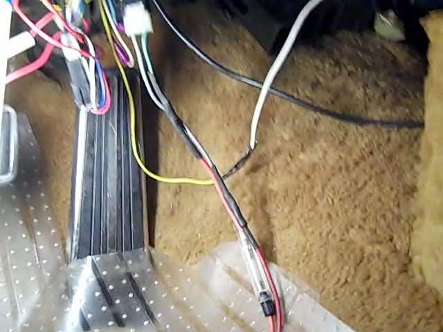

You can use your low pressure fuel pump in your tank to feed the carburetor. But you will need to disable the high pressure pump on the rear frame. You can cut the light blue wire that goes to the pump. It is located under the car near the fuel filler neck outside the fuel tank. There is a plug there for it.Tape it up or shrink wrap it so there is no shorts. You can then take you fuel line coming from the fuel tank and bypass the high pressure pump. You can keep your fuel filter that is next to the high pressure pump. I used two fuel filters. The original one on the frame and the other at the carburetor. Remove the wiring harness from the engine and push it thru the firewall. You will need to remove the wiring harness and the computer. But before you do that. There is a plug with two wires that you will have to cut off the harness for the computer. It is located under the drivers side dash. The wires on the top of the plug is the Lt blue fuel pump/s wire. It turns into a Dark green wire on the harness side of the plug.The Gray wires are the same on both sides of the plug. The Lt blue/dark green wire energizes the fuel pump. The gray/gray wire is ignition power. I put an inline 10 amp fuse on the fuel pump wire and connected it to the gray ignition wire. The pump will only turn on when the key is foward and not when it is back for radio listening etc. Some guys like to connect the electric fuel pump to the oil pressure switch. But if the car sits for a few days, it will take longer to start the car. I installed my EGR valve but did not connect it. There two small wiring harnesses that goes to the distributor. One is a speed sensor for the injectors. Unplug it. The other one is the ESS (Electronic Spark Selection). Do not unplug the ESS that goes to the box on the firewall or the car will not start. You will also need to find 4 bolts to mount your Quadrajet carburetor to the intake. The rest of the job is tuning your carburetor, timing etc.

Fuel pump and ignition wires/plug
