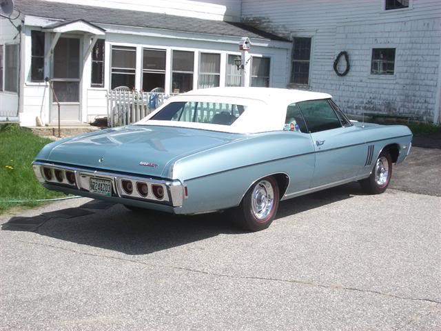

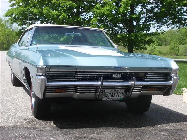

Thanks Stomper,
I hope I don't get in trouble for posting non Caddy pics on here, but here are some pics:

get in trouble? nahhh ...
them share a driveway with your Cadillac, right? we like to see who rooms with
our Cadies ... so you see, it is ON-TOPIC !
man, she's BEAUTIFUL !
i had a '68 Impala FastBack, GREEN but only a 327ci on mine.
damn, i sold it with 45,000 miles for $1,500 damn .... [sm=headbang.gif][sm=headbang.gif][sm=headbang.gif][sm=headbang.gif]
long time ago, but it is still a [sm=headbang.gif][sm=headbang.gif][sm=headbang.gif][sm=headbang.gif]
man .. 385 hp ...[sm=yikesomg.gif] ohhhhhhhhhhh like it !
