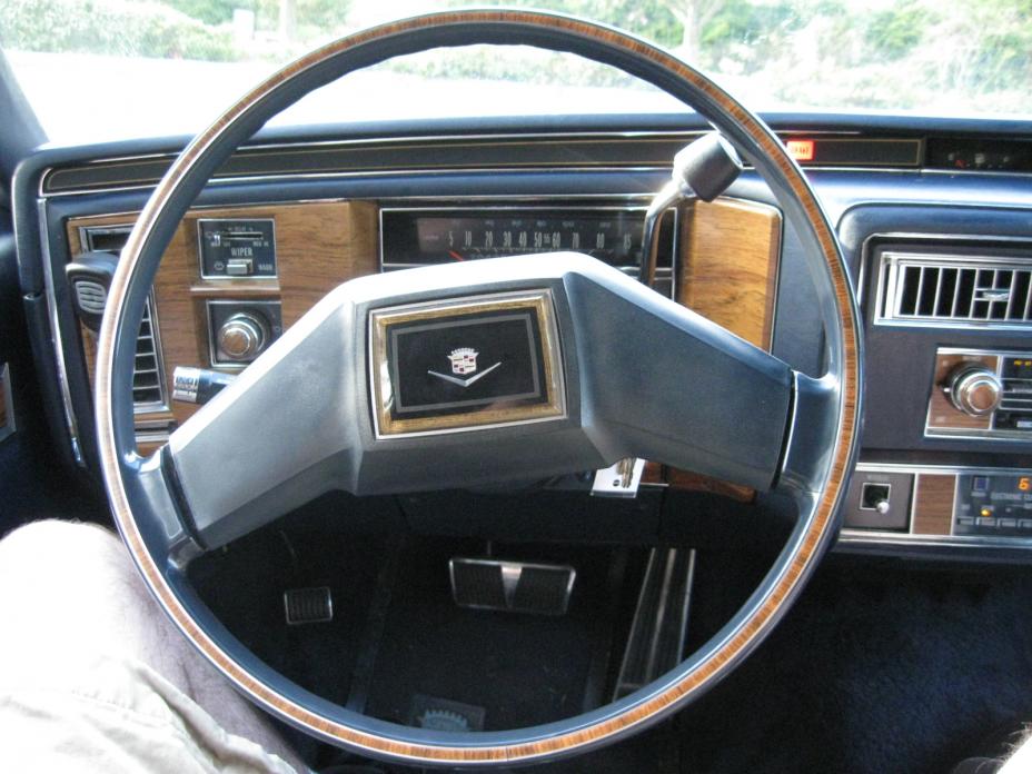

Ok what you said sounds about right, but what if there is no airbag, the center of my steering wheel is about the size of a box of checks, I understand the wheel has to come off but is it any less tedious without an airbag to unhook and reattach? Pic for description

I have done the fix on a car of this era - no big deal. No bag to deal with (with bag disarm procedure is simple). You can find a exploded diagram of steering wheel here - just select your car in listing at left side of page. Big problem is finding parts for a car this old. May require ingenuity and JB Weld.
