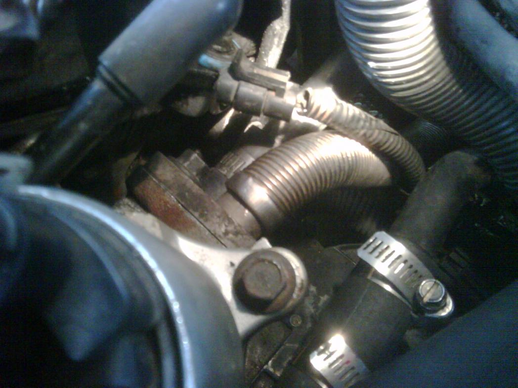

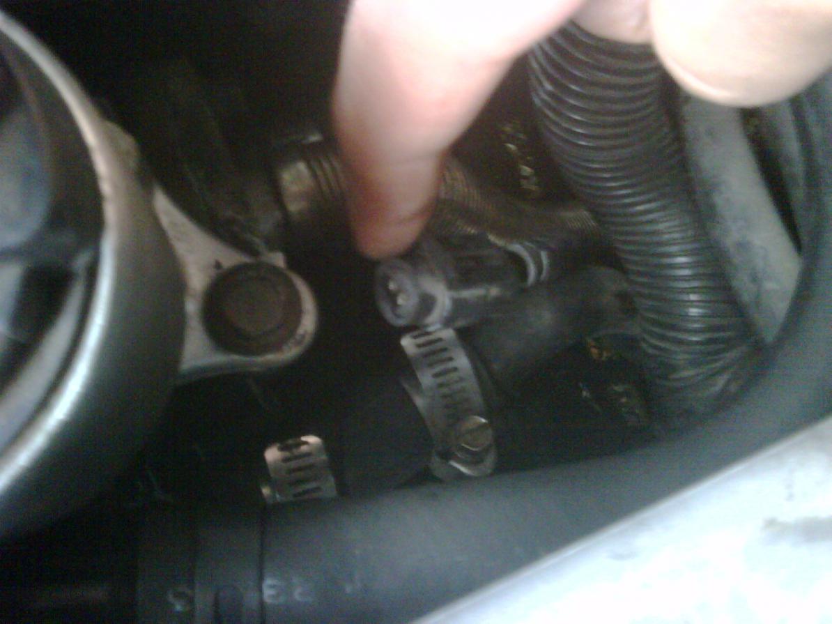

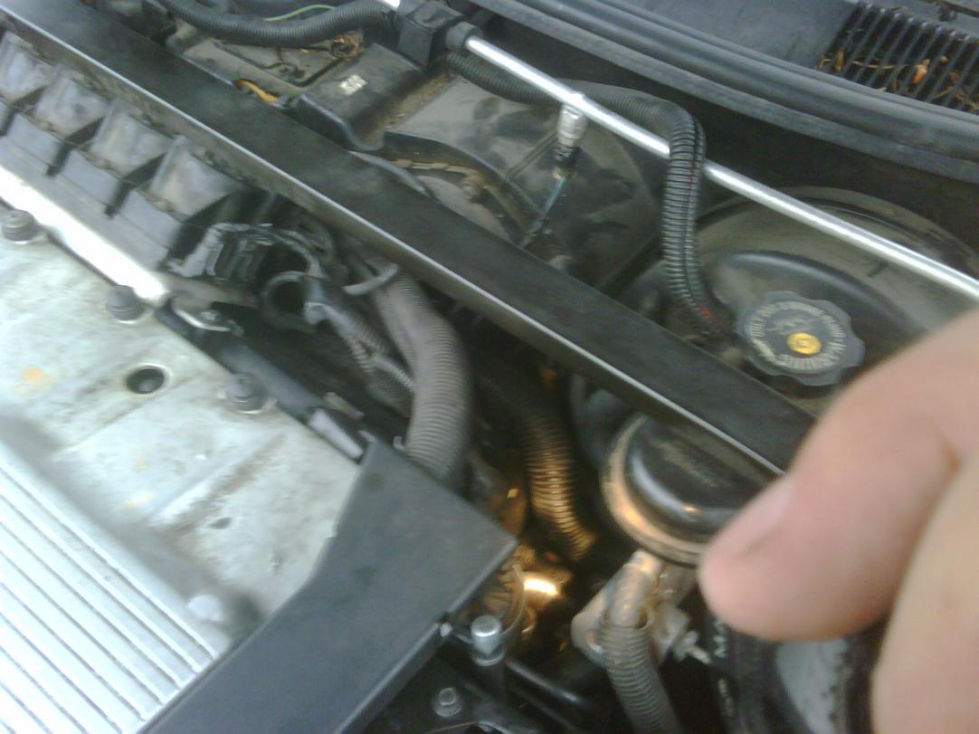

so now im pretty sure its something to do with a small connector and my transmission range sensor, or whatever the name of the sensor is that checks what gear im in. I think this because of the things i mentioned above, plus today when i went to drive it i ntoiced that the locks didnt autmatically lock when it was runnning and shifted out of park, which also meant that when i locked them when driving they didnt unlock when i parked and shut the car off. On top of that, when i went out to double check these things, it sounded super hard shifting into drive, almost like it was being forced through the gears... makes me not want to start it even though i can now...
so i took some pictures of the connector and where it is in the engine compartment. I held it up, but it looks like it actually is supposed to go down towards the tranny. Unfortunately i cant see any wires that are dangling or seem to be pulled out of this connector from the top or bottom or the car. where can i find some blow-ups of the wires and where they should be connected for the tranny or ignition system at? thanks
i cant tell you exsactly what connerctor that is right off, i have an 88 Eldorado, so a bit different. looks pretty packed in under the hood. my guess... the other end is around somewhere, mightt be under one of the parts you took off. kinda sux, but might have to repeat taking off what you put on untill you find it. check the wire range also. you only get about 2" of slack, sometimes 3", but when you put it back together you might have changed the route of the wire to where it goes. sry for the not so helpful info... but my guess like i said the wire might have been re-routed when putting it back together, or the connector goes into another wired connector and is hideing under something where you wont see it.
