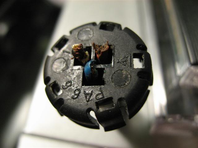

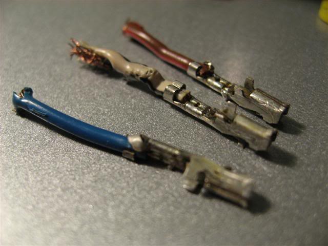

The 1st pic is of the broken wire on the plug, all 3 were broken when I actually got it off.

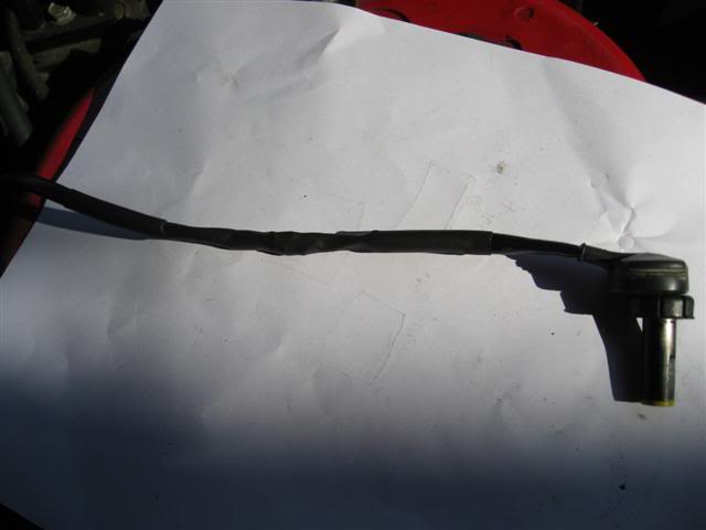

Turned the unit upside down and used a small jewelscrewdriver to pry of little yellow cap, pry several spots around alittle at a time ( so you don't break it).

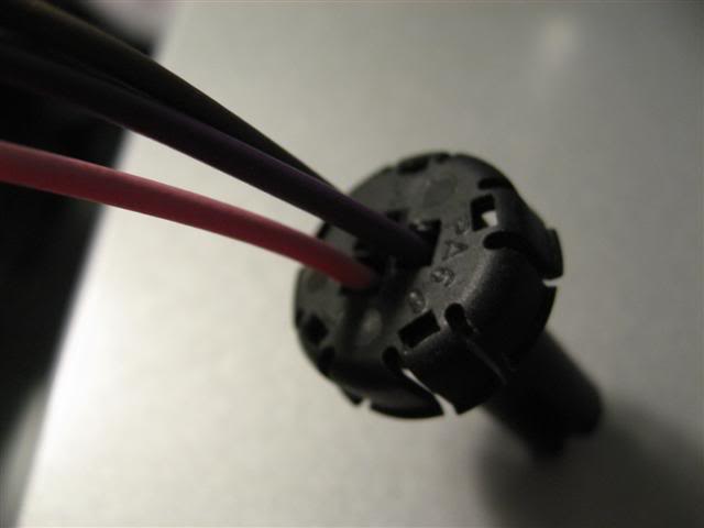

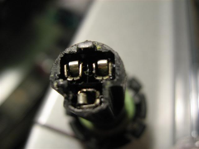

Forward push the pins with the same screwdriver. Thereis a locking mechanism so use 2 drivers, figit a little and they will come out.

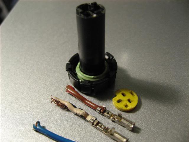

This is the result

You can then bend apart the wire clips holding the wireand solder in new wires. Then just reinsert. I used just the smallest amount of super glue in 2 spots for theyellow end cap ( don't want it staying in the shock the next time you pull it off )

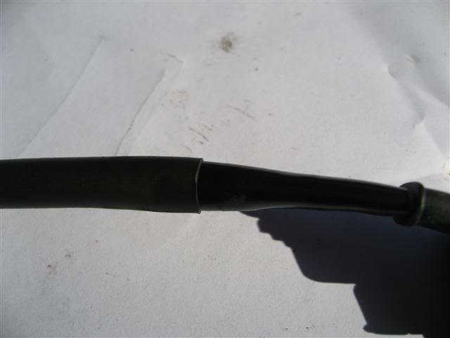

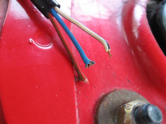

Then out to the car soldering the new wires to the oldones using heat shrinking tubes for each wire and alarge one for all to make it water proof.

note: make sure you note the original wire placement soyou can match up to the original wires.
Also soldering to the car might not be needed for all cars. The 2 donar plugs I bought for future needs that I got fromtoms allantestore have a connector on them, They were labled 1990 on them. You could then just replace the wire between both ends by pushing out the pins.....
