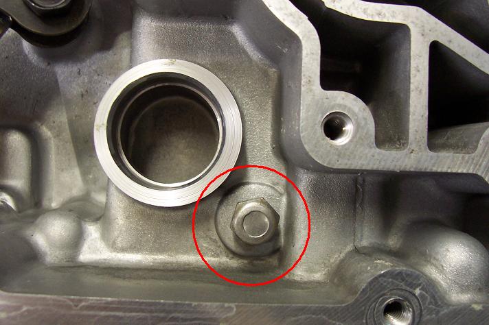

This is an old thread, but for those who want to know, the main sump drain plug is over by the shift linkage(driver side) side of the trans. It is visible with the lower pan removed. It takes a 7/16" socket...just a regular 1/8" pipe plug. I can get a pic and post it later...
Yes! please post that pic lol would be great help, so i dont losen up incorrect things in there. Hey Rick, I think its all ok so far. Got that lucas, just going to add it when im refilling up one more time.
Anyhow, i heard anywhere from 7 quarts to 12 quarts after pullin that plug, how many qurats is it roughly if anyone knows...

Pics are here...

Excellant! The best description about this "hidden plug" Will be sure to repost in few after the change. Thanks a ton.

Ok, finally got to doing it. Fluid change today. Pulled plug, Didnt seem to get much out? mayb quart and half? Any way put the lucas in there didnt get to drive it much yet so ill repost in a few days. Also did lucas in oil as well so im all lucased out..Shifting smooth for most part. Gear transition nice and smooth. Fluid ids still lokking darkish thou, brown side..at least i can feel the diffrence.
