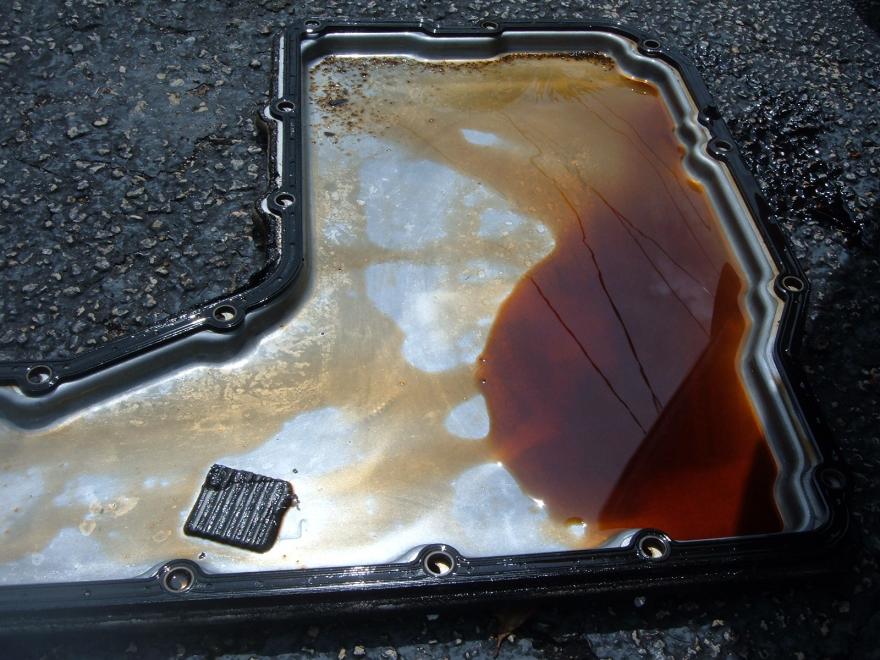

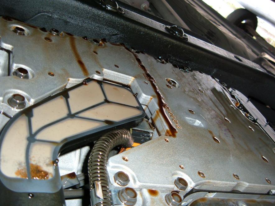

Hi guys, ok im just in from outside. did a fluid,filter,gasket change today. This is what im up with. Upon draining i removed pan and to me i believe there was minor debri in pan, one section thats it. Magnet had this like silver cake material on it. I have took some pics if anyone wants to see. I wanted to note that i did not pull the hidden plug on the side...I did this on purpose as to slowly introduce the new fluid into the tranny then maybe in about a month or two, change it again, and pull the plug...please post any replies or input. I can say upon starting up and shifting into gears it was alomst if the car was BRAND NEW!! lol. now after a few test runs it did seem to harshen up a bit..very minor. but in all i think it was succesfull and hope all stays well into future here.

post the picture. how much silver metal are we looking at?
yes, re-service again in about 1,000 miles; dont forget to add LUCAS again.

Heres a pic of mag/pan. I put 500 miles since change, shifts are still kinda same-bit firm or not as smooth if you will. but the transition from N to D drive very very smooth. but D to N kinda rough...anyway i will get the lucas in absolutely. I saw two of them one was one mentioned above and the other lucas which said to use if tranny was in operating order meaning no slippage or leaks. was like dollar less it said did almost same as other one, renews fluid, clutches, conditions, shifts..etc..not geared toward slippage or leaks thou..any experience with that?
considering the miles on your sts 99, i'd use the lucas mentioned above. spend the extra buck....XD imo things look pretty norm.... (pics)
