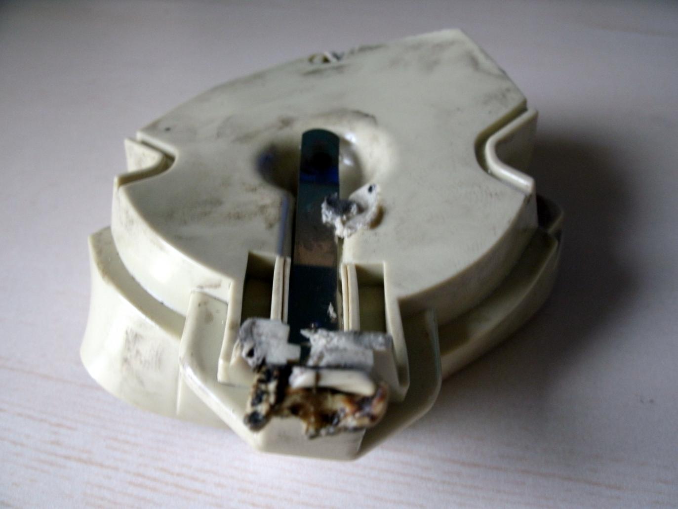

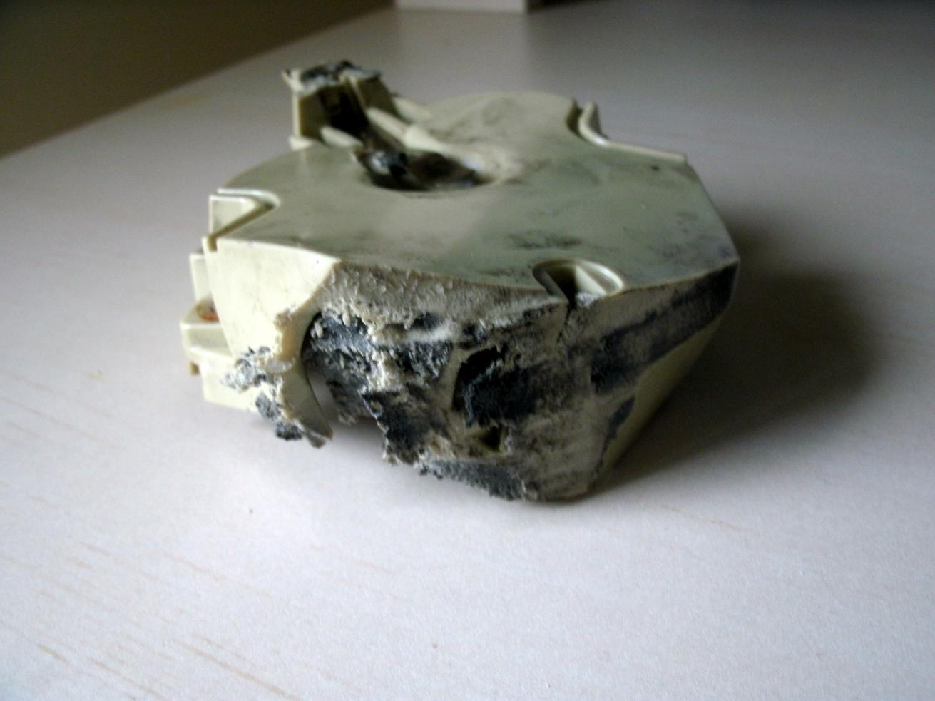

The Seville was down the last 10 days because it stalled and would not start. I found out the rotor was shot and replaced it today. It was burned and warped. (see attached pics) Sure don't know what could have caused that! Anyway when I took it for a test drive the shift select error was gone!
