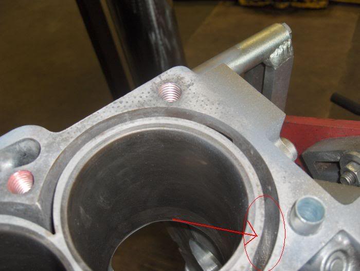

The blocks are cast so porous in some cases the leak oil or coolant or both right through the side of the block. When the molds are poured the the hot aluminum is splashed up the sides in the casting and cooling occurs it causes layers & voids. This is a example of the porousity. Blowing air in this head bolt hole comes right through the block in the area circled....... I 'm having difficulty uploading a pic. working on it.
This block has threaded inserts intalled This is why the coolant pellets are added on the assembly line.
https://www.cadillacforum.com/forum/...1&d=1268930750

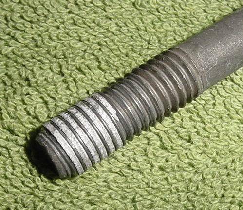

This is typical.https://www.cadillacforum.com/forum/...1&d=1268932382 Not seized galled or "bonded" as you say.
Attached Thumbnails GM Cadillac Northstar engine features & issues, coolant system protection-threadsonmainbolt.jpg   GM Cadillac Northstar engine features & issues, coolant system protection-threadsoffbolt.jpg
