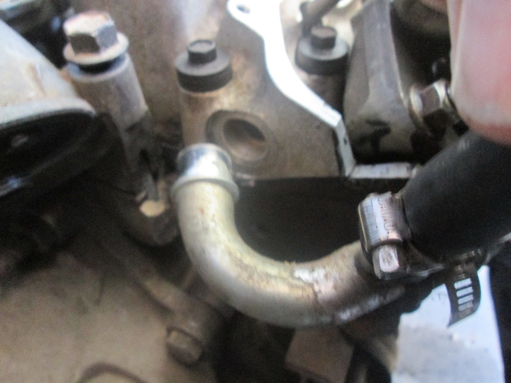

The heater bypass pipe on my Allante has rusted out. The local dealer says the part is no longer available. Is there any alternative?
Rolland

heater pipes on ebay now. You could try 86-91 Eldo/Seville for used parts, they should be similar. You could try to modify 4.9 parts. A fab or machine shop maybe able to make you something.
