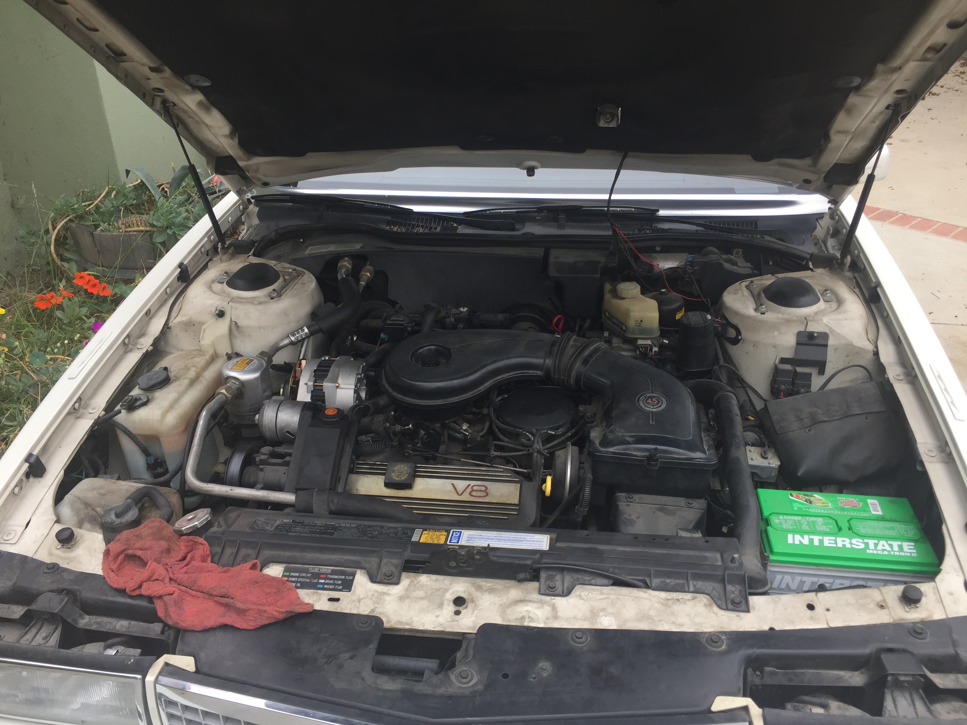

Added some photos of when we first got it/ I began cleaning road grime off engine.

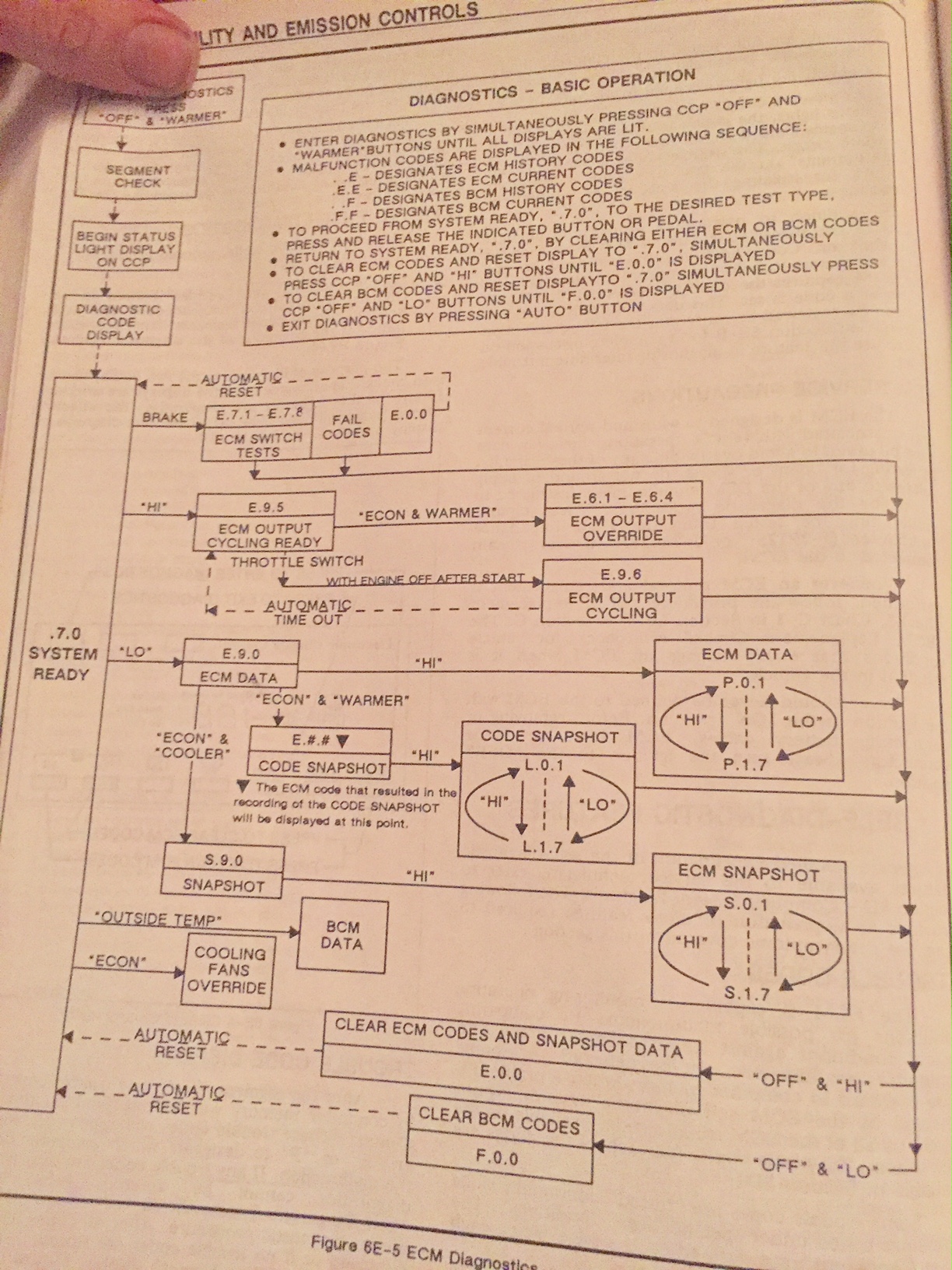

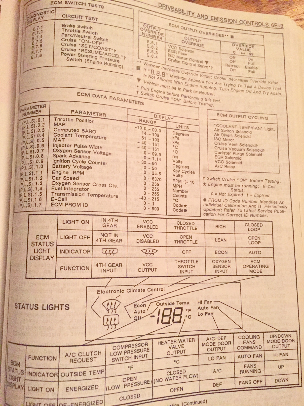

The onboard system is beast I have not yet conquered with this car, and the fsb makes it just so much more confusing!! I've attached a few photos of the pages I think my answer lies in, much of it is greek to me...are the answers lying in here? I've worked on VWs, hondas, volvos- this is my first American car. The volvo was an 1984 240, that was a dream to work on- simple, lots of space....the cadillac is much more confusing than the new vw or new Honda.
I just pulled codes- e55 was the only one before we went to a mechanic who changed the entire ISC to a new aftermarket non ACDelco part. Now the car has E22, E26, E27, E47, E52, E55. The mechanic said the idle was at 700, which seemed high to me? e52 comes with the battery being reset.
I really wish I understood how to find/ read / understand the ISC and TPS read outs. I'm a little dyslexic and simple things take a long time to sink in, but when they do sink in I know them forever. I know you hit off/warm then enter past the codes to the 7.0 then you can choose other avenues after that...I need to play more with it, but mostly I need to car to stop shutting down randomly! My girlfriend drives in hollywood to work during rush hour, and people drive like (as you would expect) crazy people and I'm afraid she will get into an accident.
