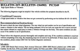

Default NHTSA Bulletin Cadillac DeVille Shake Shimmy
Here is the relevant bulletin. The problem is connected to a toe-in toe-out condition. At the last session, the engineer simply followed the bulletin and charged me 350.00, doing the same thing the dealer did before, only a little better. There is less shake, but it still exists. There may be some question about range of adjustment. This is a pristine low milage car with no accidents at all or other problems. It should not be shaking. Anyway, I'll fix it, but it's been expensive.
