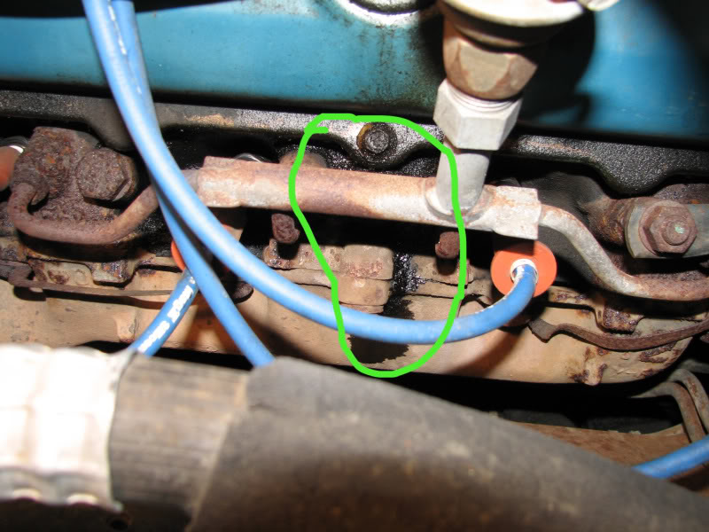

it's leaking, on the left side while you are the driver. Also I have a slight tap sound that I hope has to do with compression.
Old Mar 19, 2009 | 06:49 PM
WolfmansEldorado's Avatar
Joined: Feb 2009
Posts: 45
From: Ferndale, WA
This first one is the left side, while in the driver's seat. It is puddlish where the arrow is pointing under the cable:

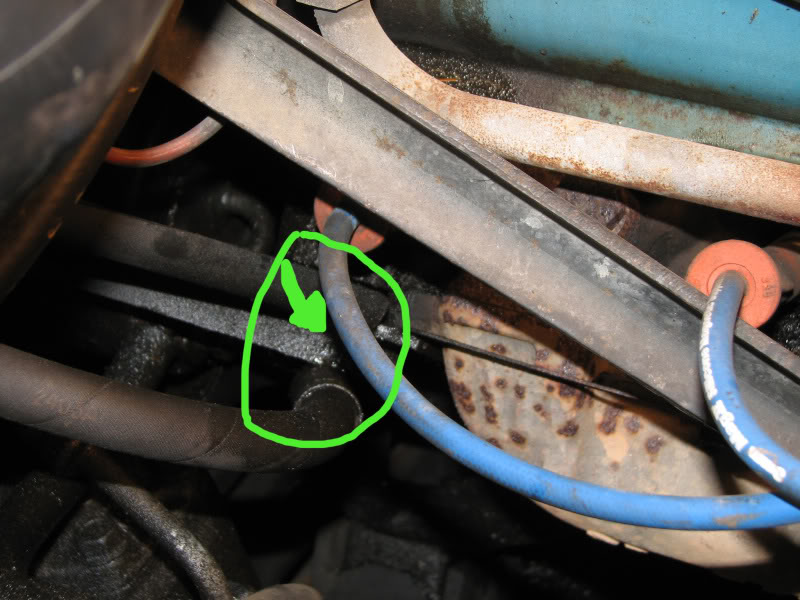

right side, while sitting the driver's seat (not sure if that is the correct term for describing engine side):

Old Mar 19, 2009 | 07:13 PM
Did you mean VALVE COVERS instead of HEADS ?
Old Mar 19, 2009 | 07:23 PM
Joined: Feb 2009
Posts: 45
From: Ferndale, WA
Stealth - yes, I was confused when you started talking about a tough job, the mechanic at aamco said valve cover gaskets and said it was easy. I got it in my head that it was head gaskets, my bad I'm burnt out rnow, i've got a friggin head cold.
Back to the store to return head gaskets for valve cover gaskets, thanks for clarification, I've only torn apart a small engine and that was in high school. I'm not fluent with part names, but I can take a picture.
Slowroll - thanks for the peace of mind about the olds engine and its usually reliable head gaskets.
Old Mar 19, 2009 | 07:25 PM
That is the valve cover gasket. Cork / neopreme gasket works best you will need weatherstrip adhesive to glue it to cover so it stays in place. Gasket will have 10 holes but will work on the 5 bolt valve cover. Rocker pivots for exhaust valves on left head near EGR valve tend to wear causing tapping noise. I believe heat from EGR causes push rods to sludge and restrict oil flow to those 2 rocker arms, so spray cleaner through push rods to make sure there clear, before re-assembling. Egr valve should be removed when replacing left valve cover.
