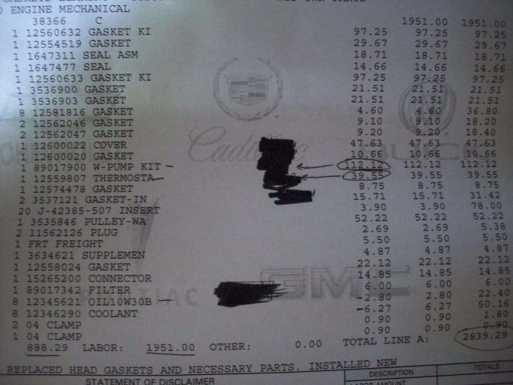

The dealer was the only place in my town that would touch my Cady every one else said "No way in hell we will even look at it!" So a after it was all said and done the bill was $2839.29 . They had replaced everything with their parts and had given me a 3yr/12,000 mile warranty since they used their parts. Its a 20hr job plus another 6hrs to timesert the block (rethread head bolt holes). Cost of dealership parts is about$888.30 and Labor was $1951(26.3hrs total)
Here is a pic of the bill to see what parts are being replaced to give you an idea.

Wow, that's a steep bill! I bet your hoping you never have to do that again haha! Thanks for the posting up that pic, I'm sure it will turn out to be useful if I do have to replace the head gaskets, it will be a good way to make sure they are not throwing a bunch of of random things on there. Anyways, my car repair got pushed back till tomorrow..... so I will let you guys know how it goes. Thanks
