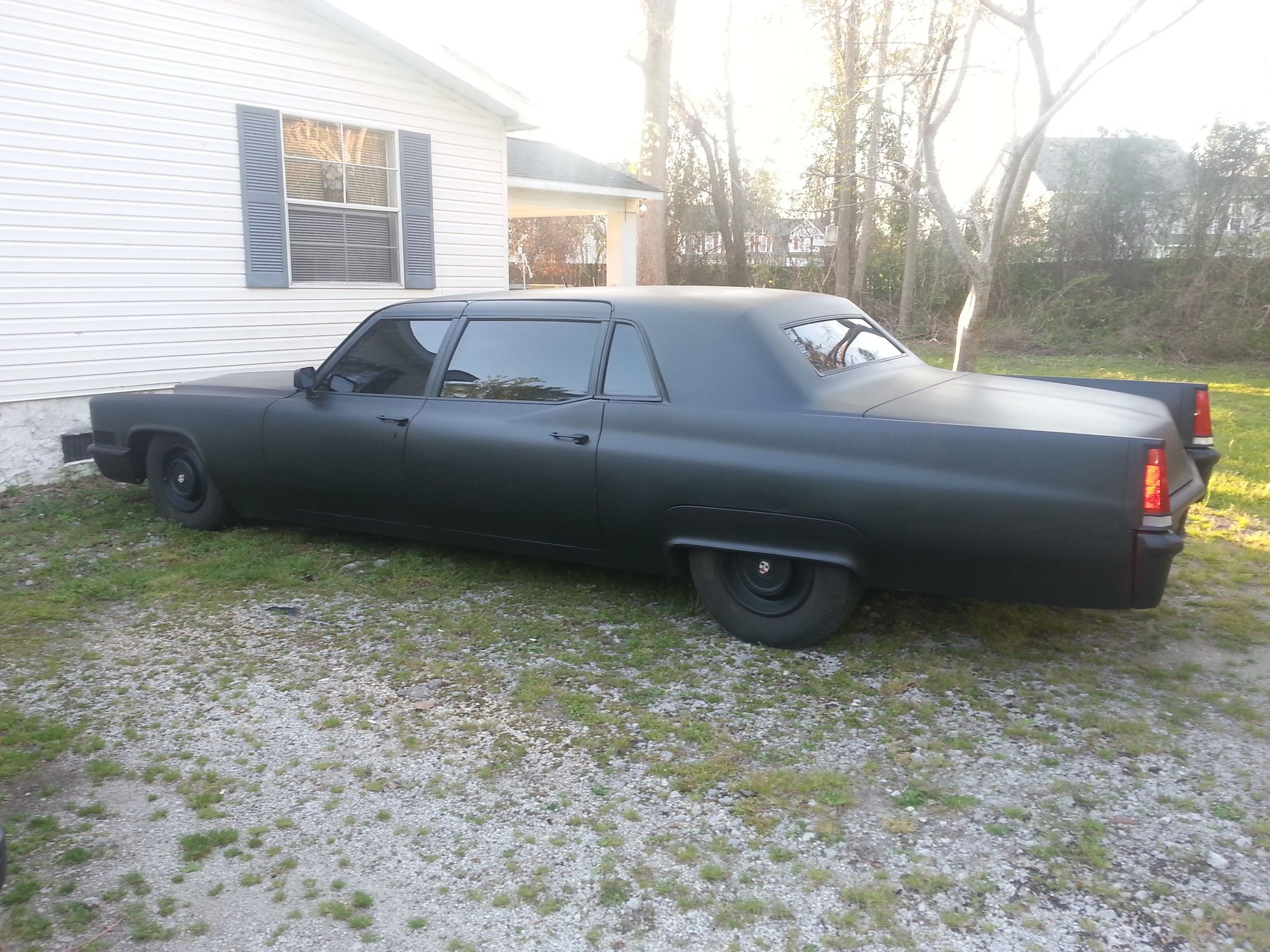

Hello,
I have a 1969 Fleetwood 75. I think the Radiator that is in it is an aftermarket . It appears to be not as wide as the original but thicker than the original. (by looking at the top mounting brackets)
I am installing a new engine and drive train. I wish to make sure this radiator will work efficiently. Is their any way I can tell if the radiator is going to work properly other than hooking it up and trying it out?
I also want to install new air conditioning system. The original had a unit mounted in the trunk .
It was removed along with the air scoops(air intakes). The holes where the scoops(air intakes) I had welded shut. I wish to install a air unit that will cool the car without using a rear unit.or could I still use a rear unit without the air intakes?
any suggestions or comments would greatly be accepted. Thanks In Advance.
