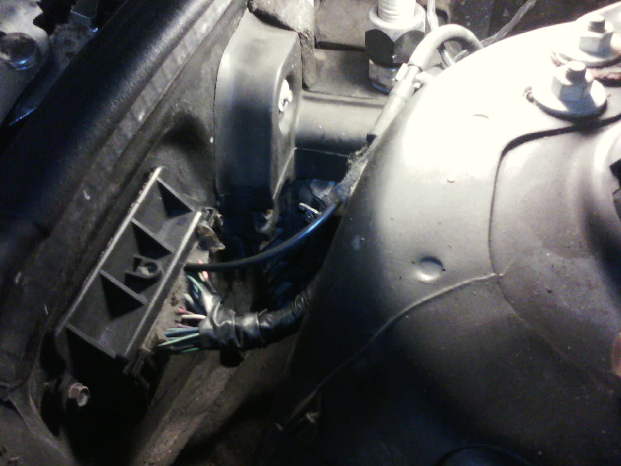

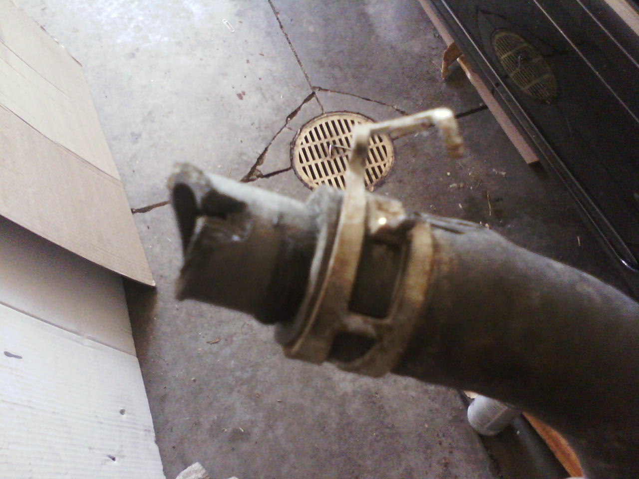

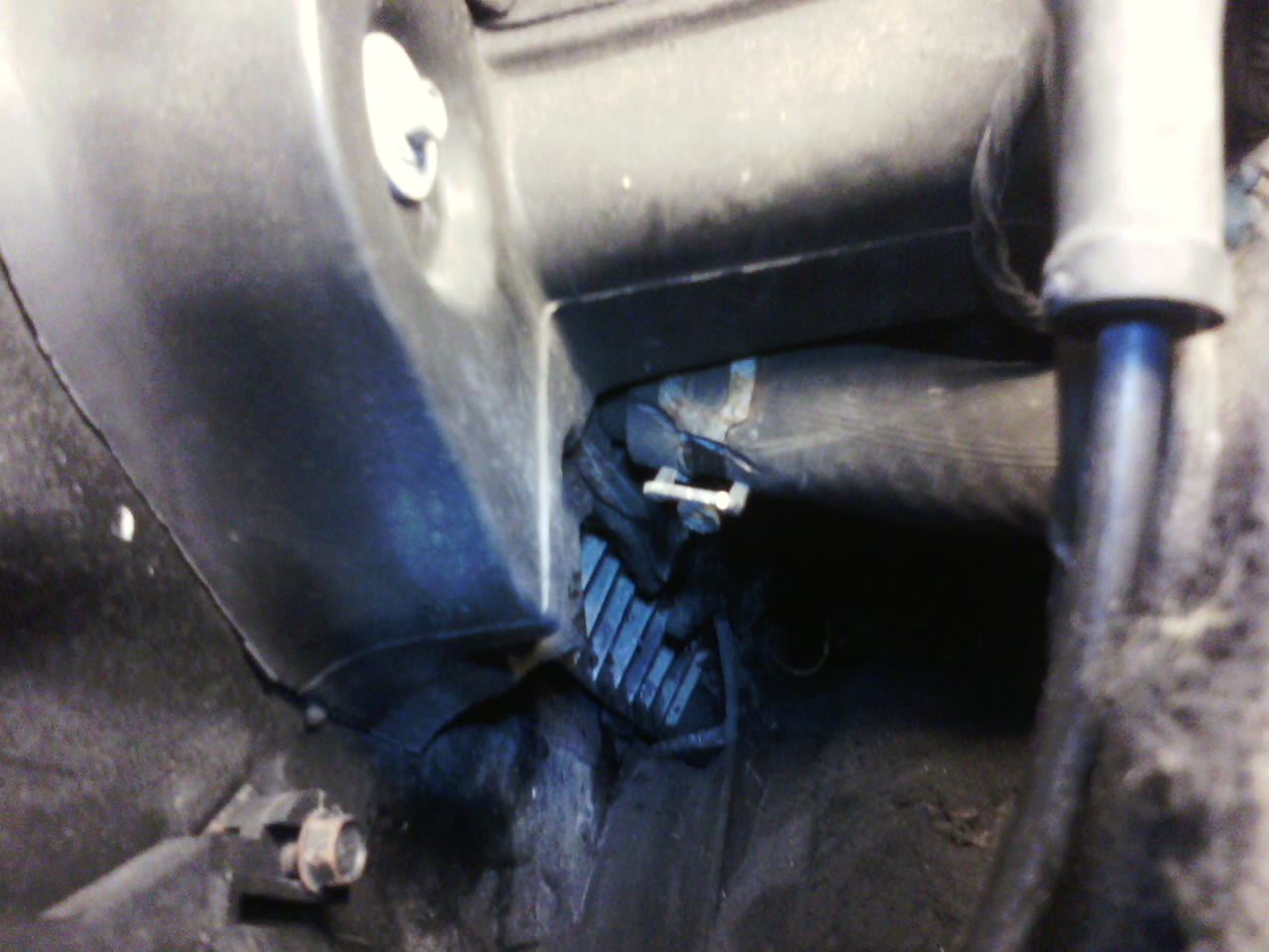

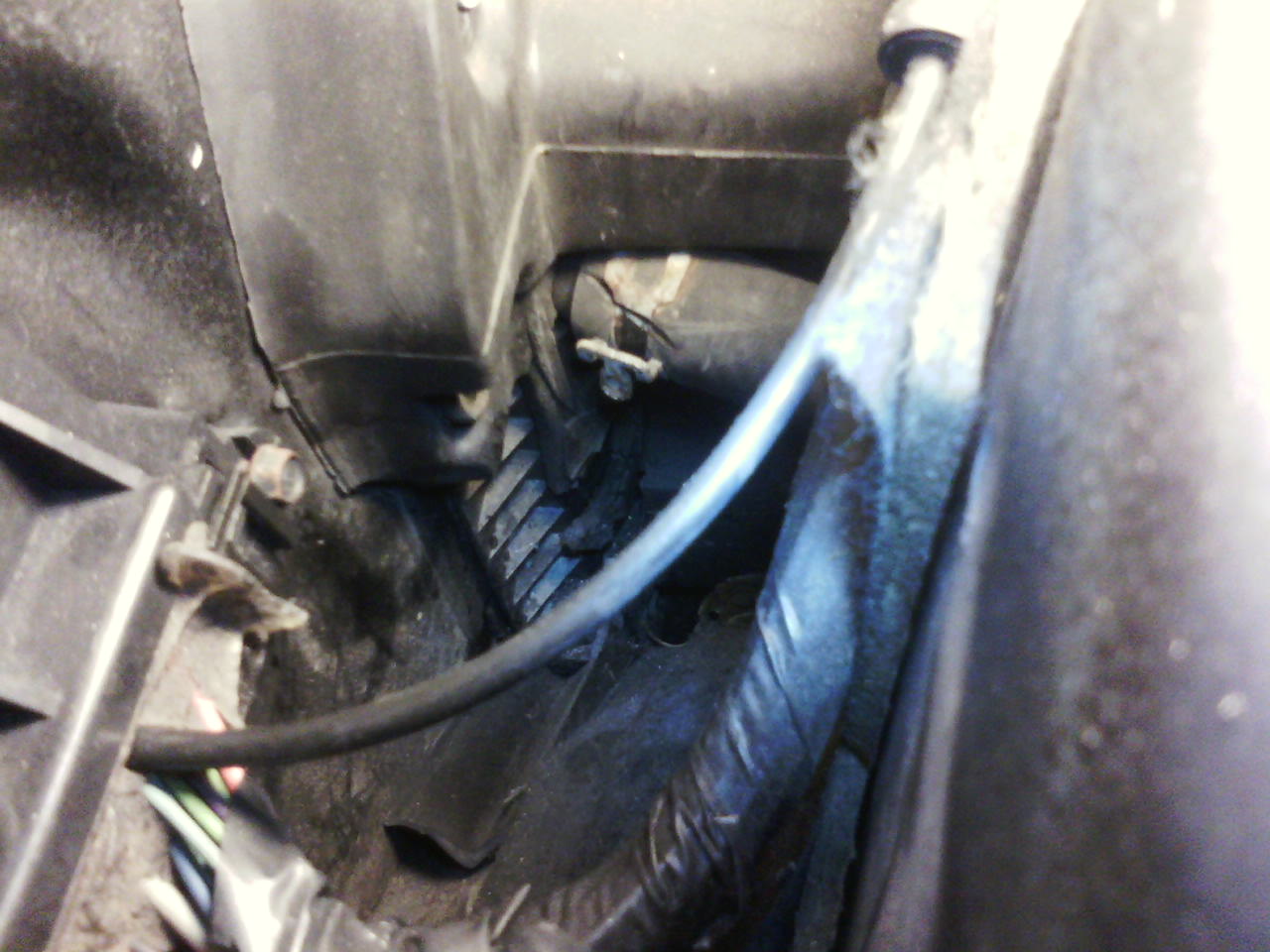

Dont normally get to bent when working on cars but now GM and my Eldorado got me. So I just got it a lil while ago and am going through everything. Found that the radiator needed replacing due to a small crack..ok. So while i have the coolant all flushed out Im gonna change all the hoses as it has 108K on it and its time I think. The hose to the bottom of the res tank and both the hoses from the heater core are a bitch due mostly to GM using these MFing spring clamps. You cant get any sort of pliers or tool on them in that area and if you get one on it they just slip off and the clamp doesn't move. So I got out my Dremel and cut the clamps off. They still hang on even after cutting them! So I cut the last one, bottom hose going to the heater core/firewall and tap it with a screwdiver to break the seal of the hose and what I'm assuming is the plastic nipple on the heater core breaks off too. So now what?? Do I gotta tear apart half the dash to get at the core to replace the broken part? Im so pissed rite now I just closed the garage door and quit! Its easy for a manufacturer to use these cheap *** spring clamps when they are assembling a car but they are hell to deal with down the line when a guy needs to do maintenance. Any help now is appreciated and how to get at the heater core or the nipples that the heater hose connect to at the firewall. By the way its a 99 ETC if it matters.

Some pics of the hose area...

There are special pliers for this one has a clamp with a cable to made to the plier, Been there. Broke heater core to change hoses. Dash stays in place glove box, programmer and hush panel come out. programmer is mounted on heater core cover. There is likely video on you tube,
