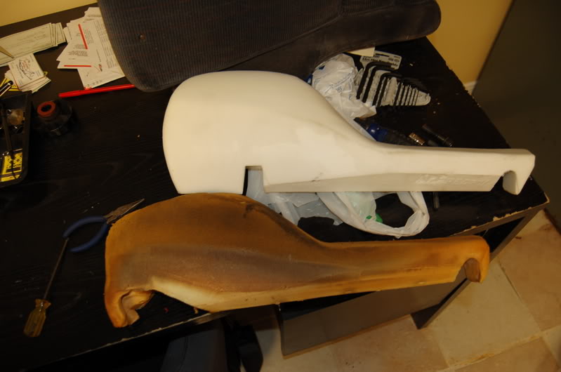

you can add foam to the frame side of the foam (I have done that) and the skins will keep their shape as long as you dont add the foam to the skin side.
however, there may well be foam replacements that are close enough to give you back the shape and firmness of 20 yrs ago.

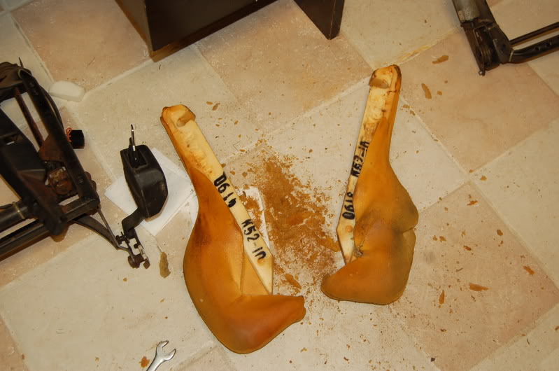

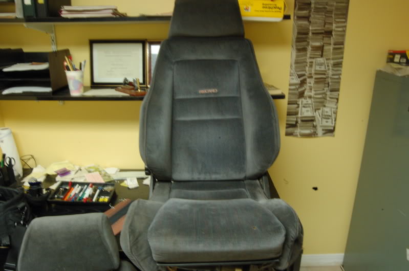

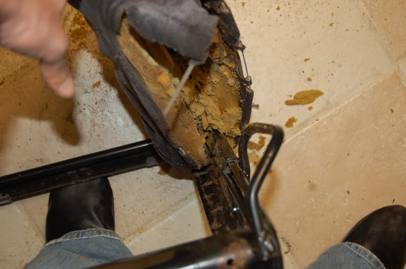

The pics below are of one such foam replacement - not a Allante. It matters not, a Recaro is a Recaro.
The foam replacements came from:
http://www.capitalseating.co.uk/
BEFORE ...
AFTER ...
