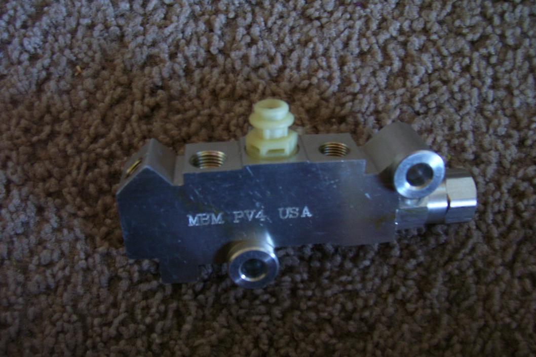

Hello everyone!!! I'm new to this site. This is my first thread. I was wondering if anyone knows how to do a disk brake conversion for a 85 Coupe Deville. I have some of the required parts. The parts I currently have are as follows: 1985 Cadillac Eldorado rear calipers w/bolts, rear caliper mounting brakets, 85 Eldo. rear brake pads and a GM front & rear disc brake prop. valve. I did SOME research on conversion kits. This was all the info. I found online for part that I needed. I'm still fresh to automotive repair but, I do know some basic mechanical skills and I'm not affraid of working on brakes (as long as I have all the proper parts). I know the lines to the current prop. valve need to be replaced or moded, and that I need new brake hoses and maybe cables. From what I've gathered (photos from the internet), the brake hoses for a DeVille and an Eldorado are very different. How would I get some hoses that fit the conversion (DeVille chassis to Eldorado brakes)? Any recommendations for hoses, brake cables and prop. valve fittings would be greatly appreciated. Thank you.

Here are the pics. of what I have so far. I also have the brake pads and rotors.
Attached Thumbnails 1985 Cadillac Coupe DeVille brake conversion-back-bracket-caliper.jpg   1985 Cadillac Coupe DeVille brake conversion-front-bracket-caliper.jpg   1985 Cadillac Coupe DeVille brake conversion-gm-prop.-valve.jpg
