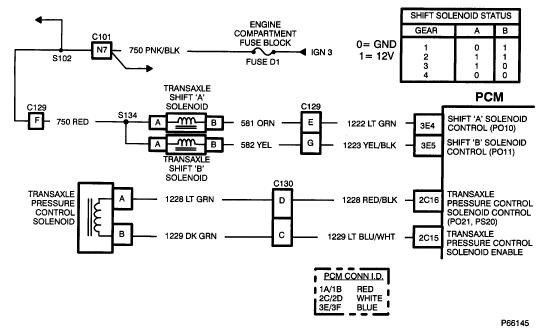

- Codes P016, P086 and P089 not set.
- Engine running.
- Difference between commanded and actual transaxle pressure control solenoid current 0.16 amps or greater for 1 second.
- Transaxle pressure solenoid energized at 100% duty cycle for 3 minutes or more.
- PCM turns 'ON' the 'SERVICE ENGINE SOON' MIL.
- PCM deenergizes the transaxle pressure control solenoid.
- Torque management is disabled.
- Transaxle shift adapts are maintained at current levels.
- Checking for an open in the transaxle pressure control solenoid circuitry. If resistance is 8 ohms or greater, there is an open in circuitry.
- Checking for a short to ground in the transaxle pressure control solenoid circuitry. If resistance is 100 ohms or less, there is a short to ground in the circuitry.
- Transaxle pressure control solenoid circuitry is OK, so fault is either intermittent or the PCM is bad.
- If the resistance measures greater than 8 ohms check for an open inside the transaxle on CKT 1228, CKT 1229 or in the transaxle pressure control solenoid. If resistance is 8 ohms or less, check for an open between C130 and the PCM in CKT 1228 or 1229.
- If the resistance measures 100 ohms or greater, check for a short to ground between C130 and the PCM in CKT 1228 or CKT 1229. If resistance measures less than 100 ohms check for a short to ground inside the transaxle in CKT 1228, CKT 1229 or in the transaxle pressure control solenoid.
