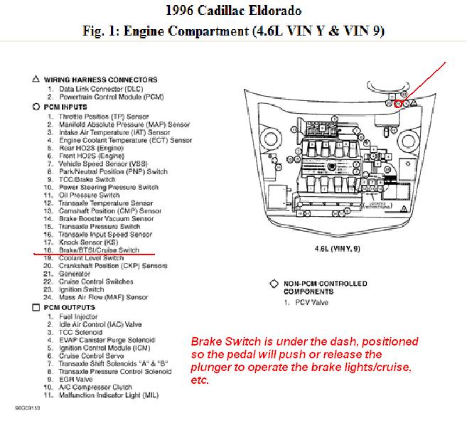

Sounds like maybe your brake switch either needs adjusting, or replacement. You should have two different brake switches, but it may only be one. The cruise control runs thru the brake switch, as does the lock-up signal, so when you press on the brake pedal, lock-up and cruise dis-engages. With cruise activated, the signal takes a different path, which may explain why it works with cruise, but not without. Worth a shot.

Thank you, sounds like you got it. Would this be something easy to find myself? Could you post a picture or video? Who would do it cheapest if I'm not able? Thanks again you are great!

No pic, but I do have this, and a pic of what the switch should look like.
Attached Thumbnails 1996 eldo torque conv slip hear something in dash?-eldobrk.jpg   1996 eldo torque conv slip hear something in dash?-swtch.jpg
