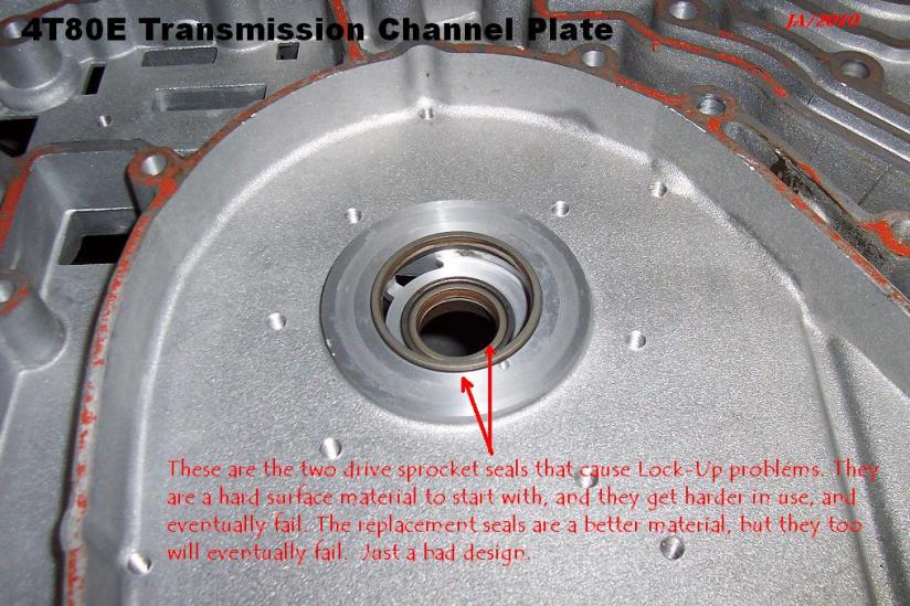

Sorry...I thought I had posted this before...

No problem, it's not too late, and I just seen where these seals are.
Anyway, I will see if it will be inside the rebuild kit I had order @ autotransparts.

The two seals for the channel should be in your kit. There are also two different sizes of the larger seal. Be sure to carefully match it up. The kit will have both sizes.

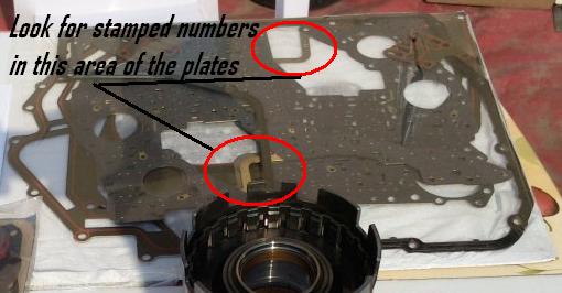

How about the main filter, in the side cover? I don't see one. The two small filters in the bottom pan can be cleaned and reused, but the main filter in the side cover should be replaced.
Also, you'll notice that there are 2-3 different lower valve body gaskets(plates) in the kit. These are the gaskets that are metal. IF you change that gasket/plate, be SURE to use the proper replacement from the kit. The gaskets are stamped with a number, on the bare metal "dog leg" of the plate. Your original plate will also have a stamped number. Just match the new with the old.
