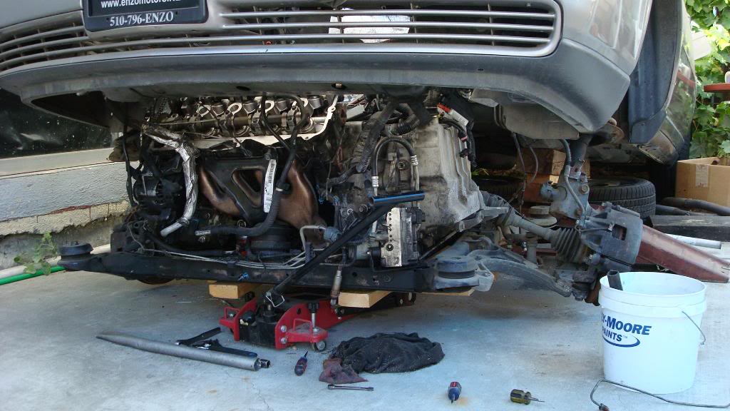

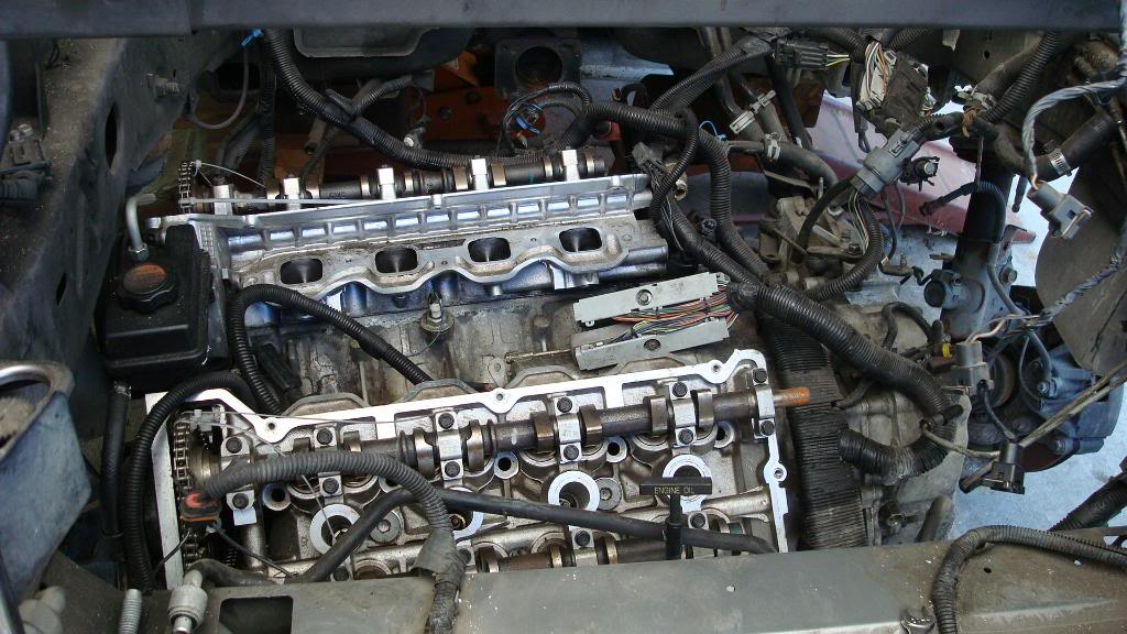

im in need of help. ive taken the powertrain out of my caddilac and ive timeserted 6 out of10bolt holesbecause my timesert kit doesnt allow me to timesert the outter 4.one of the bolt holes that has a dowel/locating pin is stripped and i cant get to it cause the dowel pin is in the way.i need information telling me how to get this dowel pin out or how to timesert this thread. any ideas/help/info/suggestionswill be highly appreciated.
the pictures are
1. the dowel/locating pins im stuck on
rest are recent but no current pics.
btw, i attempted to do this with theengine in the bay, but that proved to be too difficult so i decided to pull it out.

i hope this will help somebody one day.
1. put bolt in dowel pin
2. grab dowel pin with vise grip
3.spin and pull out!
this needs a good amount of force, so dont be gentle, lol.
