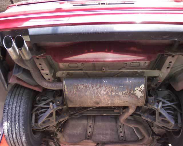

The old exhaust... blick...

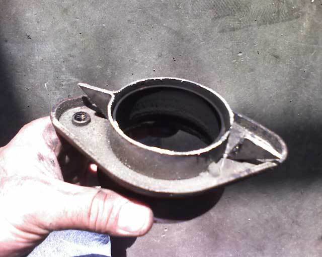

A close-up of something - I think it has something to do with junk in the catalytic converter...

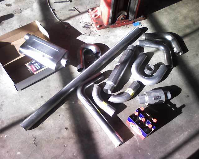

What it takes... I think the 5-pack (there appears to be one missing already) is an essential installation tool!!!!
Stainless - Edelbrock muffler - Dynatech cat and resonator (I think)

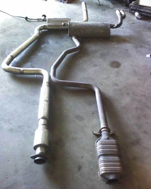

Old and new - side by side...

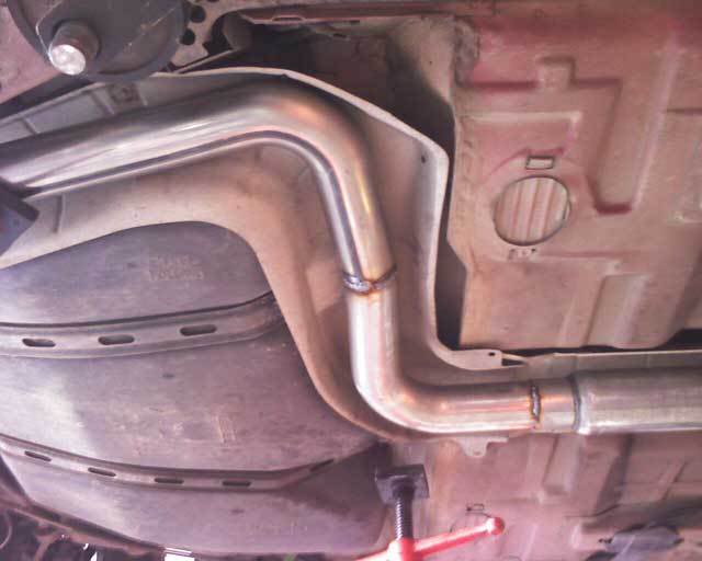

What it looks like bolted up... under the car
From the back...

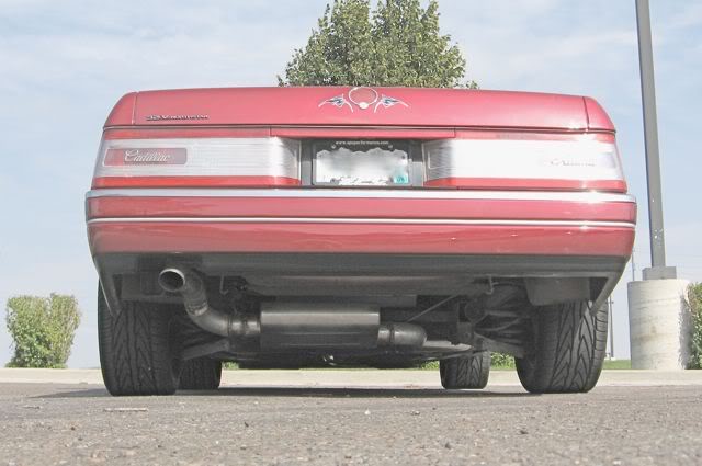

Great photos of the installation and parts! From what I can see you have larger diameter stainless pipes that have been mandral bent with a more direct flow through the Edelbrock muffler added to a high flow cat. This is a nicely done system. It is sure to have released a good number ofhorses. As for finding a chrome tip why not polish the stainless tip already installed.

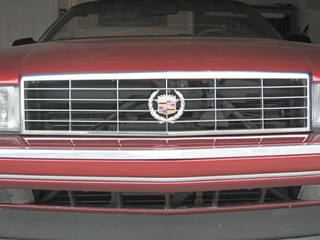

Got the filter - and Lance just took off the air intake snorkel and then left the port through the fender wall - added some grid to keep me from sucking up small animals

Oh, the grill looks better without the snorkel - it just looked silly...

you got a grill shoot before the snorkel was yanked?
as to the GRILL ... L@@K at my profile .. something removed from MY GRILL ...
i didnt think that a pimple on a pretty face was pretty.
you may want to try that and decide if you like the looks .. .

Fox, the photos of the car on the hoist has different tires from the shots on the ground, you hiding something from us? Why not show us a nice pic of the new meats too? That is fine looking rubber andimo you should leave the traction control engaged. No sense tearing up those beauties.

about the only thing i can say, is that the original exhaust was painted ... BLACK.
you should be able to find black paint on the old ...
I don't have a front-on picture of the snorkel - but here is what it looked like from the top. I am sure someone with a '93 could provide a front-on shot...
Stealth - you can see a bit of the old black paint on the muffler in the first picture. I only wanted to match the "footprint" of the old exhaust - this is far, far removed from original - it is closer to a racing exhaust -
Good catch Katzman - new shoes!!!! You can see the new Toyo tires in the "butt" shot - got them for a song (thanks to industry discount, and they run Toyos on one of our sponsored race cars).
Wider than normal - 245s (spec on the Allante is 225/60/16) - so lower aspect ratio at 50 - great look - lots of rubber on the pavement - no rubbing whatsoever.
I would image that these will wear pretty fast though - soft rubber - speed rated w. I kept the Michelins - just in case. But, I was finally able to get the ugly wheel weights off the face of the wheels and they balanced them with weight tape on the inside - so they balanced them side to side as well...
